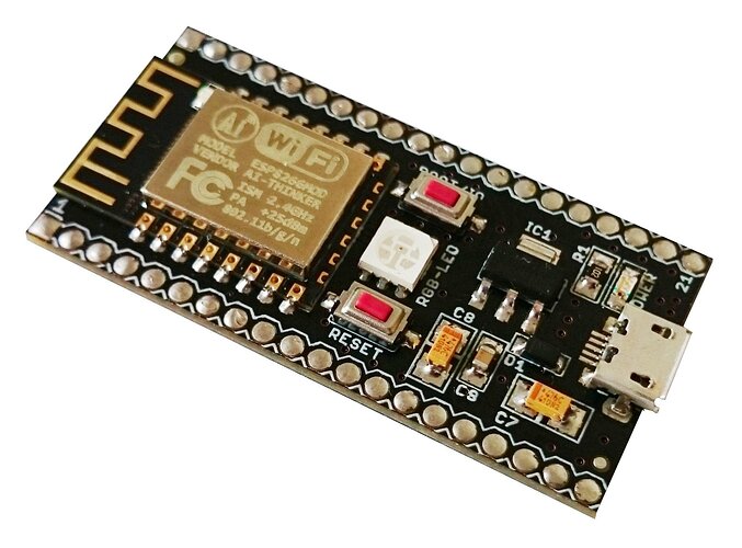

Arduino Mega 2560 has 4 hardware serial ports: Serial (USB to PC), Serial1, Serial2, Serial3.
You don't need software serial.
How do you know it doesn't make it to loop? Put a Serial.print in loop to confirm it doesn't make it. Take out the return in loop() as well.
xhahahx:
It's ESP8266
Then why put
Arduino Mega 2560
An ESP8266 looks like this:
A Mega looks like this:
Already you are starting out by confusing those who would lend a hand.
With the next post, start over.
Post the well formatted code in code tags, the device being used, the problem, what the code is supposed to do and what it actually does.
I don't know if software serial on an ESP8266 will run at 115200 baud but I have my doubts. I'd try 9600 first. I also doubt software serial even works on an ESP8266 because the interrupts needed for the WiFi to work mess the timing up. I couldn't get it to work.
I take it that despite the confusion you are using an ESP8266 not a Mega.
I suspect you have an Arduino mega and an ESP-01 connected to it, that you are trying to control with AT-commands, still only guess work though. It is not the most efficient way of using an ESP.
i also don't think it works, but to be fair, other than including the library, there is no object created, so in a way it isn't used. Maybe this code was migrated from an UNO. hwSerial (both 0 & 1) are being used.
