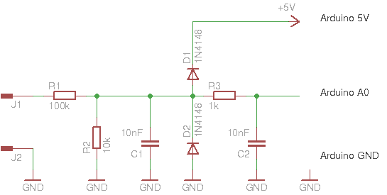

Well I would use diodes to the rail. Do not use Zeners.
Never use zener diode for an analog input. They leak current. For an analog input, use clamping diodes.
The attached schematic shows how to use clamping diodes, an extra 1k resistor is used to protect the Arduino internal clamping diodes.
R1 : the value sets the range of the voltage to measure
R2 : for example 4k7 or 10k, determines the impedance of the circuit
R3 : 1k to protect the internal clamping diodes.
D1,D2 : The 1N4148 are fast and good for this.
C1,C2 : optional capacitor for example 10nF or 100nF, use none, one or two of them, according to your preferences.

Of course you need a voltage divider. Keep your highest resister below 60k, to help match the impedance of the arduino.
Use an RC (or LC) circuit to help clip spikes. Of course put caps on the analog input (.1uf).
What is your source of power for the arduino? If it is the car, then add extra filtering/caps on the power rails.
I still think the best way is a 1:15 divider (=1/16) and a 100n cap.
Simple, effective, it takes advantage of the stable 1.1Aref, and the same code also works on 3.3volt Arduinos.
As said in post#1, if you use 100k as the biggest value, the pin does not reach 5volt untill you put almost 80volt on the divider.
If that would ever happen, everything else in the car would be toast.
Dividers with protection diodes are great if e.g. you want to take a fast pulse from the ignition coil.
Other than that, they are tits on a bull.
Leo..

Thanks for that
I found some 1000nF caps that I will use
Just a word of CAUTION:
Make sure the resistor to ground is never disconnected, or the arduino may suffer.
Turning off the power is almost the same situation.
The pin is then almost at ground potential, and any voltage divider will try to phantom-power the Arduino through the pin.
