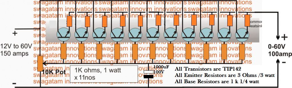

So I have been doing some research and I have found this
The issue I'm having is that the guy asks for a circuit that steps down form 240v ac. would this still work to step down from 36v DC to 24v DC?. I have looked at the data sheet for the transistors and they are rated for 100v max but I can't find a minimum voltage. Dose that mean they will work from 0- 100v?

This project is a kludge. You are trying to fit together parts that are not compatible, and any solution will be expensive at those power levels.
Start over, with motors and/or power supplies that are compatible.
