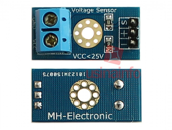

I'm trying to use a voltage sensor of 0-25vcc but when I do this using a code taken from the internet it works correctly, but when I write the sensor code in my design sketch it reads once correctly but a 10 sometimes wrongly, I spent a lot of time researching but I did not find anyone who had a similar problem to share a solution, attached the sensor image, any code I get on the internet works but when I do the join with my sketch it reads values strangers.

What voltage are you trying to sense? Appears to be a 5:1 voltagedivider for DC.
I'm sorry spycatcher2k I'm still new here and also with Arduino programming
I attached a file with my code
hello outsider the sensor reads up to 25vcc and it's great for me this value I'm going to work with something around 12vcc follows a link from the sensor https://www.ebay.com/itm/2pcs-Standard-Voltage-Sensor-Module-For -Robot-Arduino / 261961157472? Hash = item3cfe1a0b60: g: FdQAAOSw-vlVnncO

Sure sounds like a faulty connection, check your wiring carefully and the sensor circuit board with a magnifying glass looking for cold solder joints or broken traces. Flex the board gently, see if that makes a difference, I see E-Bay doesn't list that anymore, sold out? Defective batch?
if I use this code alone it works perfectly so we can say that it is not the right physical part?

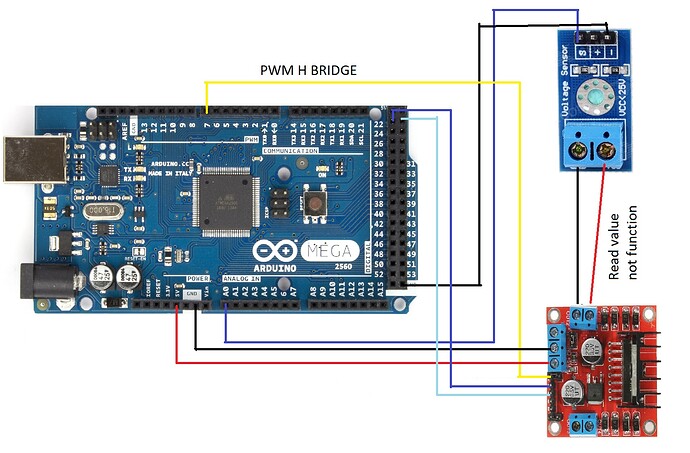

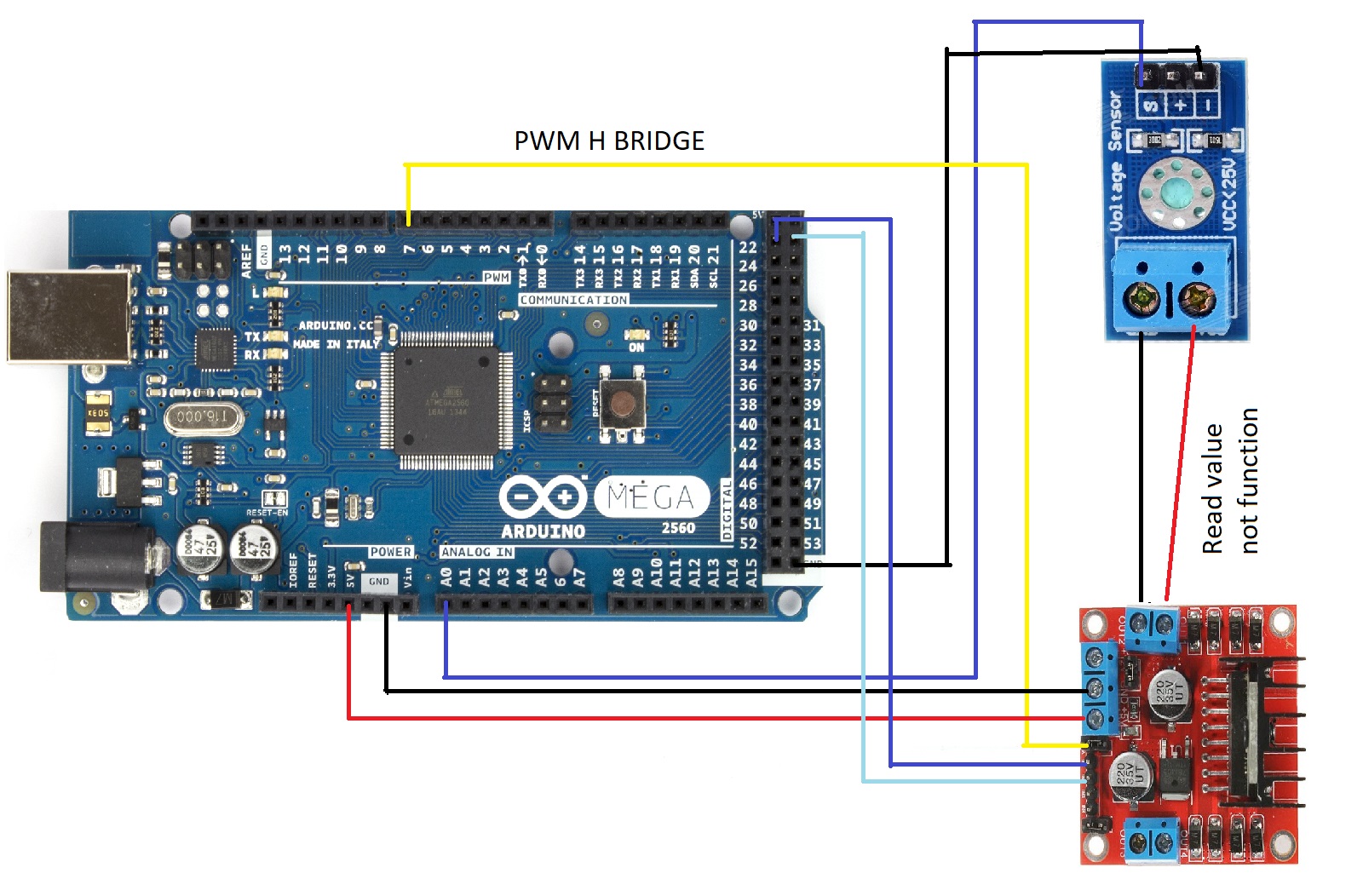

Yesterday I did some more tests and discovered important information, I'm trying to read the voltage of a bridge l298n h but I can not, if I connect any external source to my circuit the sensor works but when I try to read the output value of the h bridge it shows zero, I'm forwarding an attached image of my circuit.
OPs circuit;
You cannot do that with the motor output of an H-Bridge, you are shorting one motor output terminal to GND through your voltage sensor.
Why do you want to measure the output of the H-bridge?
Tom.... :slight_smile:
Hello Tom
I am sending a value through the pwm port of the bridge and set something around 1v and would like to display this value on a lcd screen, like a multimeter, but when i try to read through the sensor i can not but by my multimeter it works.
(deleted)
hi spycatcher2k
My multimeter works is normaly, it shows the value correctly even when I'm changing the value of pwm
