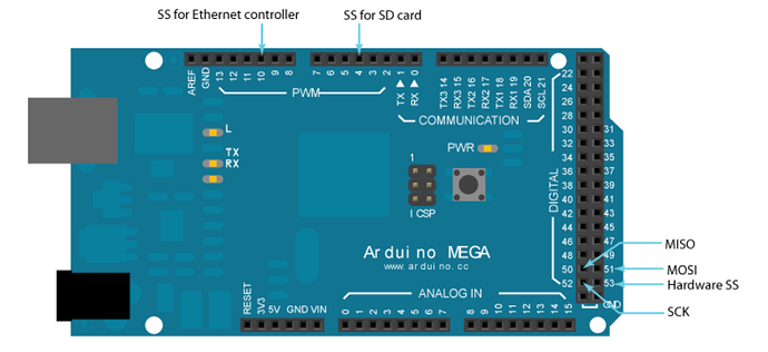

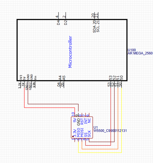

I'm trying to create a UDP message sender using my Arduino Mega with a W5500 Ethernet module. I wired the W5500 to the Mega as shown in the diagram below:
I use the MISO, MOSI, SCK and Hardware SS

however you MUST connect a CS Pin as the W5500 is a SPI device.
Show us YOUR wiring diagram AND real pictures so we can check each wire on the picture.
Using a correct wired W5100 with CS on Pin 10 I get with your testsketch:
11:01:02.294 -> W5100 Ethernet controller detected.
the wiring is something like this (minus reset because i cant find the reset pin in EasyEda)

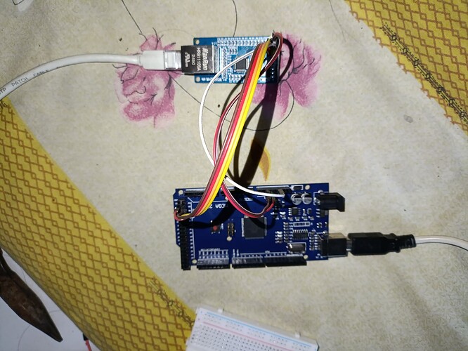

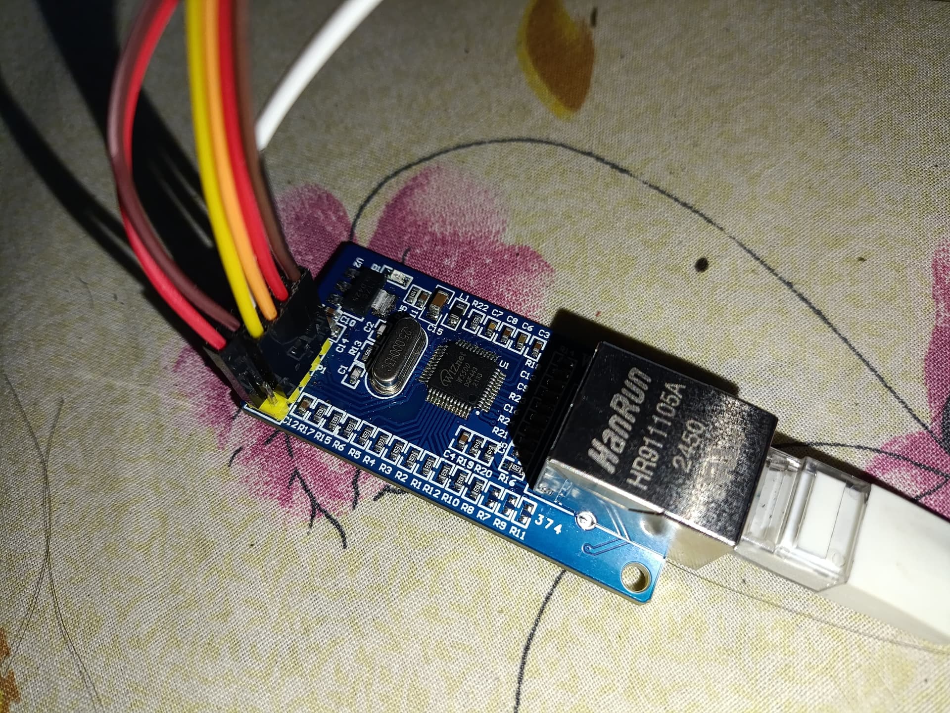

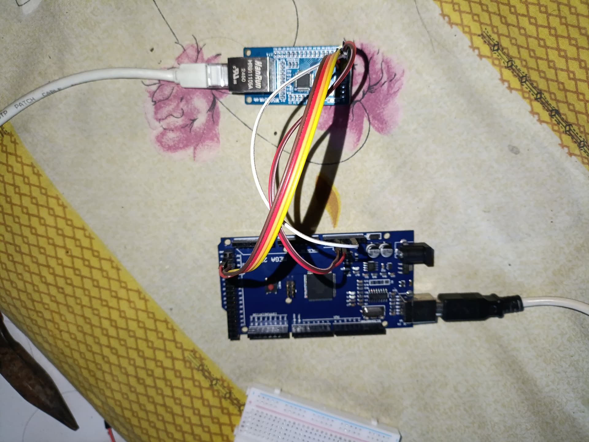

Here are real photos of my current setup:
Top view of the wiring:
W5500 module close-up:
Arduino Mega connection:
connect the Ethernet CS Pin to Pin 10 of the AVR and retry.
(Your pictures are of poor quality. I can't check where each cable goes. You could have used at least different wire colours. This not only helps us - but also yourself).
If I were you I would use RED only for power cables and Black only for GND.

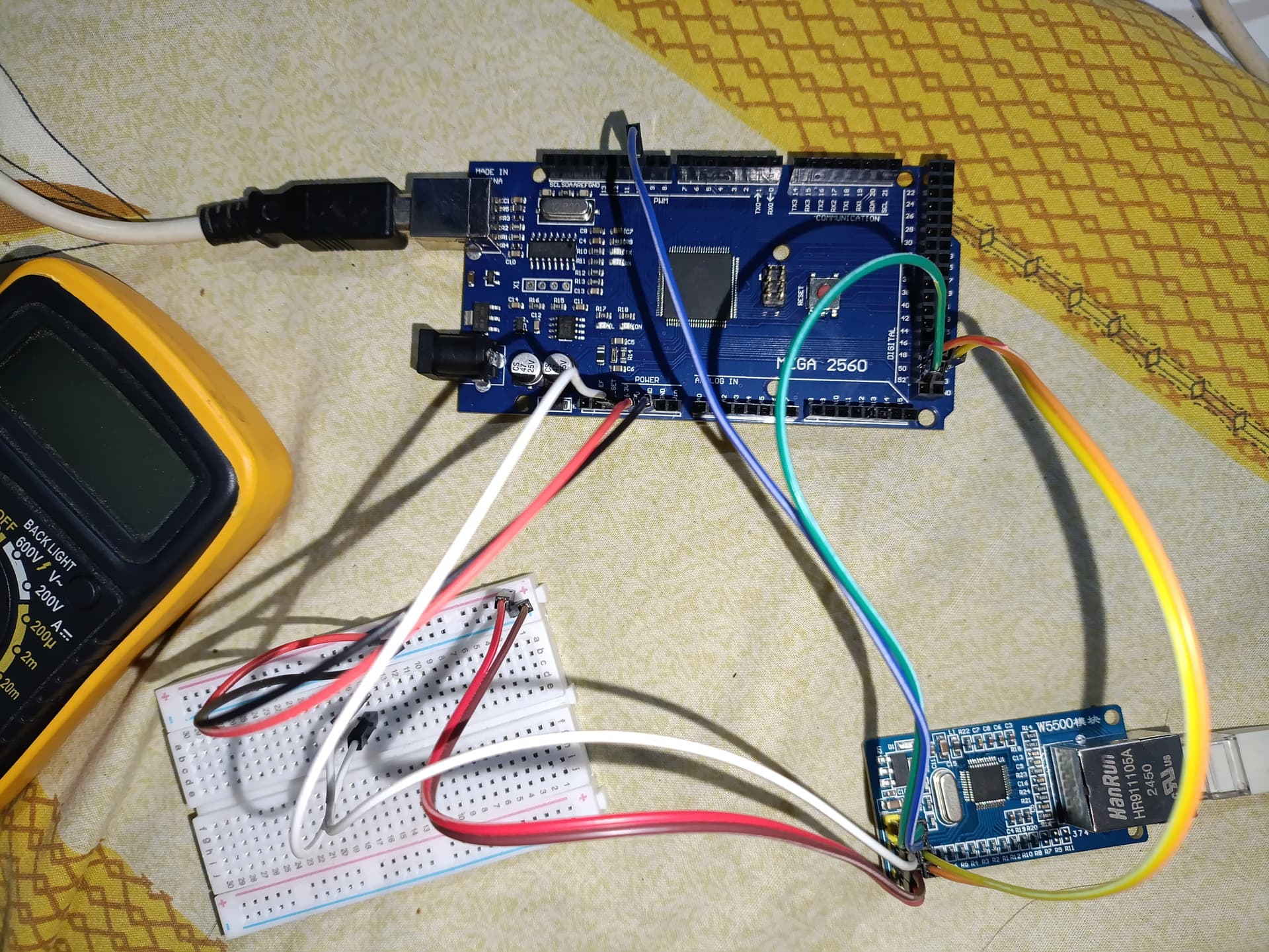

Sorry about the image
but i change as you suggested
red = 5v
white = RST
Brown/Black = GND
Orange = MISO = pin 50
Yellow = MOSI = pin 51
Green = SCK = pin 52
Bllue = CS = pin 10
this is the image
the output is still like this, what do you think the problem ?
17:03:01.533 -> Ethernet shield was not found.
what's about the LEDs on the breakout board?
is power indicating that the boards is powered?
the state of the two leds of the RJ45 socket?
