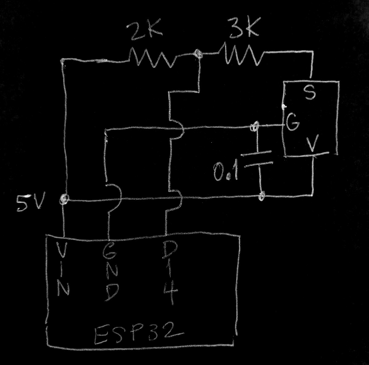

Water flow sensor YF-B5 shows incorrect pulses

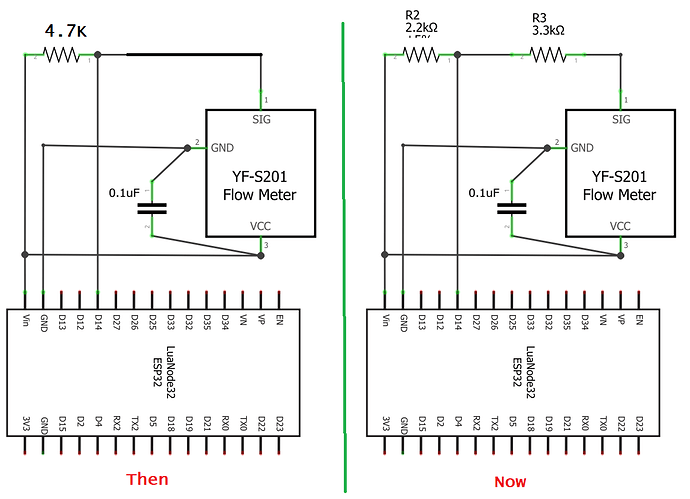

Is that how things were before my modification?
(The FM output was pulled-up before, as it is still, the difference being the mod has a tap at approx. 3V)
Do you mean whether this problem with Wi-Fi appeared before? No, everything was fine before adding those resistors.
And that is all that has changed?
Other than the "3V tap" it's the same.
I hate fritzing because I cannot correct it (without downloading fritzing which I shall not do, or doing a lot of fuss and bother with ms_paint).
Does fritzing make a fritzy-pic from a schematic or only the other way round?
There are discrepancies between the fritzy-pic and the attempted schematic.
Yes, if I change back schematics, everything works (still, pulses are not shown correctly).
Basically I add and move the parts around in the Breadboard section, also Schematic and PCB gets generated automatically as I do it. Then, I export the image.
Sorry, I think some wires were behind one another and it might looked like it was incorrect, please check the one below (I've repositioned them so it would look more like yours). Still, breadboard stays the same and ESP cannot connect to the Wi-Fi.
It's puzzling to me that it did not tank the wifi Then but that it does Now.

My assumption, given the 'Then' ckt, it seems the flowmeter output is 'open collector'.
What if you remove the 2.2k ?
From the Now? I think I mentioned it in post #38. It does connect to the Wi-Fi, but I did not check anything about whether the data is correct. If you agree I can remove 2.2K, I will leave this sensor working for a while to check the data correctness or any weird and random deviation of pulses. Thanks.
Ok. yes - I am losing it.
Remove the 2.2k ("R2") and see if Data is good.
(Why not?)
The trouble is in understanding the configuration of the flowmeter output (internal).

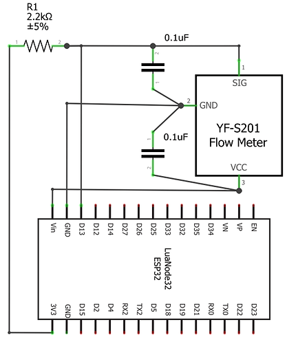

Fixed the divider. Added second capacitor to provide some hardware debounce (limits the max pulse frequency to around 3kHz.
Image removed ... see next post.
Is the output not 'open collector'?
(And wouldn't R2 and R3 have to be swapped?)
The 4k7 didn't scupper the wifi, but 'voltage-divider style' did.

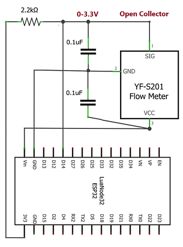

(I've removed the diagram above to avoid confusion .. thanks)
Oh, if its open collector, then maybe use the 3.3V pin as a pullup?

OC or not? I don't know. The original presentation/diagram looked like it was.
The microcontrollerslab article (above Post_26) leads me to suspect that it is not OC. Or something (??) else.

@dlloyd, as far as I have tested your provided variation, I did not receive any random pulses. Basically I've tested throughout these last days, and everything seemed fine. Is the schematic and
diagram correct as far as you have you showed?
Schematic:
Breadboard:
Not sure if the last problem with the inaccurate water consumption associates with the schematics, hardware or my code, but the data still seems incorrect (at least no random pulses occur).

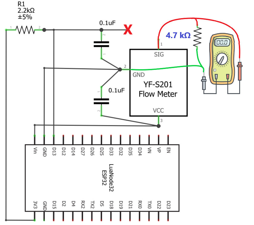

The diagram looks OK, just not sure if the sensor outputs 5V pulses or if its open-collector type. Could check with a multimeter or scope.
Earlier, there must have been some spurious switching noise ... the second 0.1uF capacitor is filtering this.
My model is YF-B5, the flowrate range is 1-30 L/min. The tests I've done were in the range of that - my "very low speed" filled a cup of 500 millilitres in like 10 seconds, fastest one in 3 s.
Well, as I have given my results above, they are indeed not consistent at different flowrates - different water running speed resulted in different pulse outcome (counting throughout each minute). Not only that, but also I was in the given range of 1-30L. Or maybe I did not understand what you meant with inconsistency at different flowrates. If yes, could you please elaborate on that or is there anything else I could do regarding this issue?
For this I would need to connect red multimeter's wire to yellow wire of the water flow meter (looking from the diagram), black to ground? And If I power my ESP and multimeter always reads 5V, it's output voltage, and if it shows 3.3V when wheel is spinning and 0V when not, it's open collector?
Thanks for your input and help.
Yes. Also:
  • disconnect yellow wire from esp32.
  • connect a pulldown resistor (1K to 10K) from yellow wire to GND.
  • If you continuously read 0V with the flow meter running, then its open-collector.
  • if you read 0-5-0-5 ... or varying voltage with, then it has an active push-pull output.

I put one end of 4.7k resistor in breadboard where yellow wire comes in of the water flow meter, the other end - in GND line. Touching both sides of the resistor with multimeter when the water was not running resulted in 1.61V (constant), when running - it varied between 0V to 1V (sometimes reaching 1.3V). Could this be correct? Why it is not showing 5V? And does this mean it's push-pull? How does that change the schematics? Thanks.

Did you disconnect the yellow wire from the ESP32?
