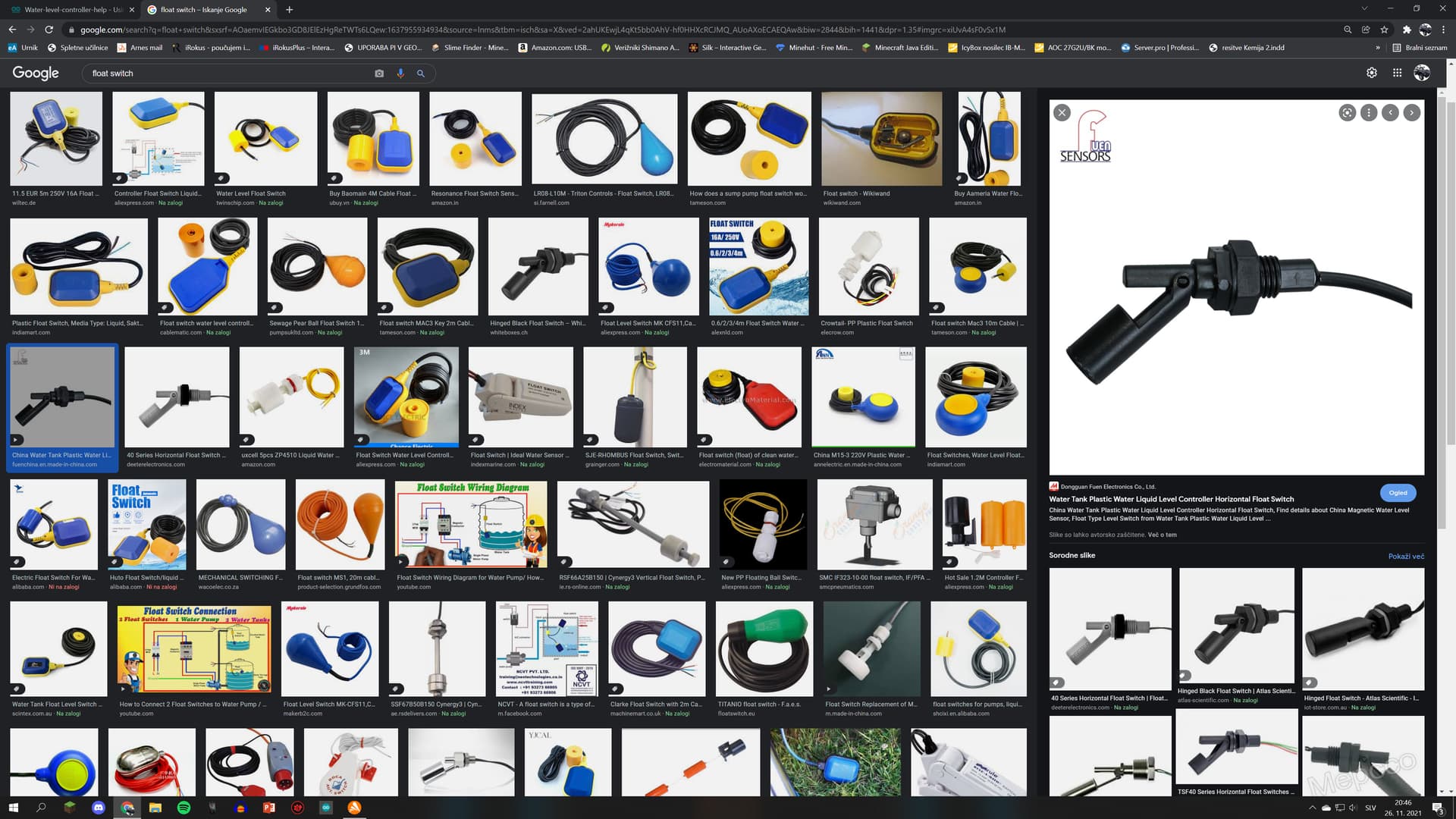

I have 1000 liters tank. Please help me with a code. I have float switches. Im from Slovenia and my english im not so good.
What part of the code is difficult?
I have relay on pin 13, low level 2 and high level is 3. Water starts going in tank but i dont know how to code it to stop. All automatic
Relay is for pump
Post the code You have so far.
Have You tested simple code exercising the relay? Maybe post schematics for the relay control.
i have done this but i dont know code for stop the water when its full.

I have exactly those float switches to control the water in my irrigation system. I have a solenoid valve to control the tank filling, not a pump, but the rest is the same.
My wiring has ONE lead from both switches connected to the Arduino ground, the second wire from a switch goes to one Arduino Nano pin and the second switch wire goes to another Arduino pin. Both pins are identified as input pullup.
Has been working well for about 3 years.

You don’t need any processing power at all , just use float sensors and power the pump through them , bit of relay logic will do it
I dont know how Hammy
May I recommend that once the pump is enabled that the pump runs for a time period instead of to a level. After the run time, the level is checked and if more filling needs be done, then another do another motor run time.
You responded whilst I was putting a picture up lol
I just googled it !!
