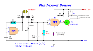

I have used this to some success
http://diyelectronicsprojects.blogspot.com.au/2012/08/fluid-level-sensor-circuit-diagram.html
N1 is an oscillator that via C1 applies AC signal to the water.
Just repeated the N2 circuit for as many water levels I needed.
Using N3 and N4.
Use the N2 output directly to your Arduino digital input, leave out T1 and the relay.

Just wires of different length, like you your original post.

i used that ..but is there a problem..i apply LED each transistor.. it so hard to detect water..
Where did you apply the LED?
Did you use a current limit resistor?
