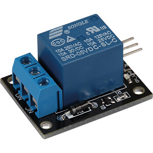

I want to create a project in which I have a soil moisture sensor and a water pump. I want the water pump to be turned on when the moisture of the soil is under a certain level. When it gets over that certain level, I want the pump to stop.
I have these components:
  1. Soil Moisture Sensor LM393;
  2. A 5V water pump;
  3. 3 x 10k ohm resistor;
  4. SRD-05VDC-SL-C KY-019
  5. Breadboard
  6. 5V from my laptop
  7. Arduino Uno
The question is: How do I connect all of them to an Arduino Uno? What to which pin? (I'm sorry, I'm a beginner).
Hello czky
Keep it simple and stupid firstly.
Run some tutorials for the hardware selected.
If you are happy with the results of the tutorials you can merge these to your project.
Does the relay module have electronics on it to power the relay coil or is the coil current from the initializing device, such as the microcontroller?
The SRD-05VDC-SL-C relay is a type of relay known as a "signal relay", which means it is designed to be controlled by a low-power electronic signal, such as that from a microcontroller. It does not have electronics on it to power the relay coil. The coil current is supplied by the initializing device, such as the microcontroller, that is sending the electronic signal to the relay.
The MCU does not supply the current needed to drive the coil of a relay.
Cover the exposed metal connector parts of the soil moisture sensor with silicone.
The pins to use is mostly up to you.
May I suggest to not use the scheme of the moisture level is correct stop the relay now. I found it takes time for the water to travel in the dirt. When the water from the pump gets to the soil sensor a lot of water has flowed from the pump into the soil but the moisture level reading has a lag due to the flow of water.
Instead I run my pumps for 11 seconds, then wait one minute, take another reading, and if more water is needed do another 11 second pump run. Repeat till the moisture level has been reached or exceeded.
Don't power pumps or relays from the controller pins. The tiny strip on the board might not manage the currents.
