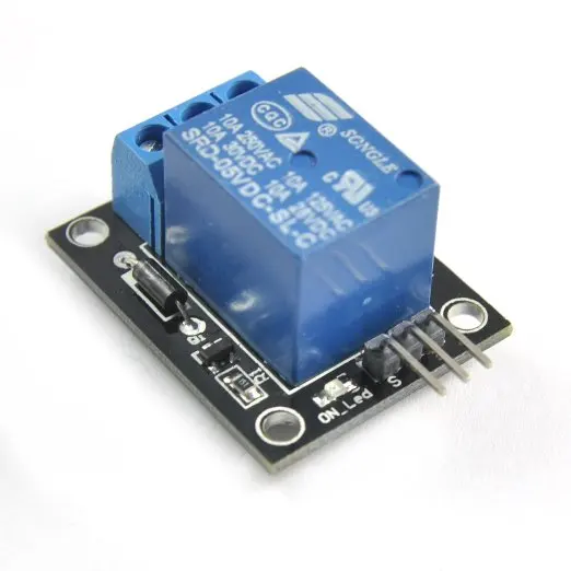

My current setup is an arduino nano, a soil moisture sensor and a relay connected to a 5v pump for watering my plants.
The problem I'm having is that although the led stops blinking when soil moisture reaches over "700" the relay stays on and keeps pumping water making for very wet and unhappy plants.
I'm not much of a code monkey but have the suspicion i'm using the if statements and/or the loops wrong? Any help would be greatly appreciated.

it seems like your second if statement needs {}
edit: also you should have first if statement end before second if statement starts. otherwise it will only turn off sensor if the reading is exactly 699 or 700
Also I would use the Relay NO not NC because if for some reason the Arduino fails and no longer sends signal to pump the relay will stay on and you will flood your plants. (This would mean you switch your digitalWrite(RELAY1, HIGH) and digitalWrite(RELAY1, LOW).
