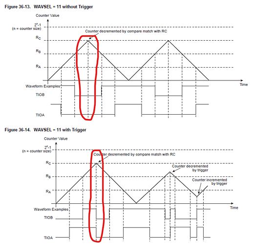

In the UPDOWN_RC mode of software triggering, I see that when there is an external trigger to RC, when the counter starts decrementing, the TIOA output goes low. However, in the case without any external trigger, the TIOA output is not toggled when RC reaches its peak. Is there any way to do this for the upper case as shown in the figure, without using any external trigger?
