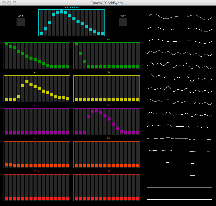

Hi @bastenhoor,
Okay, here is the Arduino IDE version.
Tone fundament is selected by a voltage (i.e. pot) on A1 between 27.5Hz (piano note A0) and 4123.5Hz (note C8).
/*  Arduino UNO R4 example code - Sound Synthesis
 *  Using Timer 7 interrupt at c. 44.1kHz
 *  Super-Fast sine calculation of frequency and harmonics from ADC value
 *  With fast non-blocking ADC analog-read and DAC analog-write operations
 *  Susan Parker - 6th April 2025.
 *    Realtime sine calc with Paul Stoffregen's 11th order Taylor Series Approximation
 *    https://www.pjrc.com/high-precision-sine-wave-synthesis-using-taylor-series/
 *    Note: I have condensed the Taylor Series code to a single set of inline asm calls
 * This code is "AS IS" without warranty or liability.
 * There may be glitches, etc. please let me know if you find any; thanks.

I did make an application using OSC and Processing on an iPad where you could put in the rise and fall of each harmonic and show the resulting waveform.
It is from Chapter 14 of my book ( Arduino audio projects ) entitled "Spoonduino" This is what the display looked like:-
