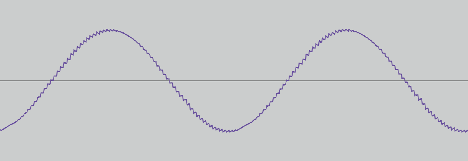

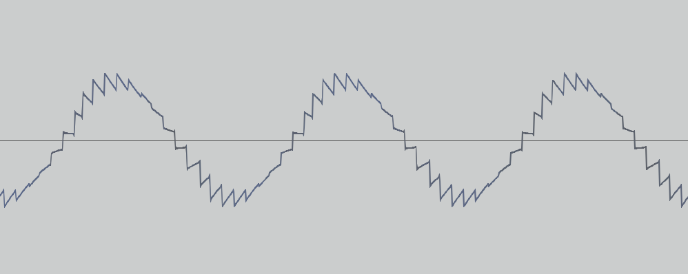

@Paul_KD7HB - I coded up my "naive" version again. Code is like this:
int srate;
float curFreq;
float pi2 = 6.283185307179586;
  Serial.begin(57600); while (!Serial) { ; }
  Serial.println("Enter sample rate.");
  while(!Serial.available());
  srate = Serial.parseInt();
  while (Serial.available()) { Serial.read(); } // flush extra line endings
  Serial.println("Enter frequency.");
  curFreq = Serial.parseFloat();
  Serial.print("Using sample rate: ");
  Serial.print(srate);
  Serial.print(" for frequency ");
  Serial.print(curFreq);
  analogWriteResolution(10); // 10 bit DAC is max on Zero
  analogWrite(A0, 0);
  Serial.flush();
  Serial.end();
  analogWrite(A0, (int)(sin(curFreq*pi2* (((float) micros())/1000.0/1000.0) ) *511.5 + 511.5));
...this generates waves that do have a fundamental at the desired frequency, but they are messy with lots of distortion products (though again, better than yesterday for some reason.)
E.g. sample rate 1000 frequency 50Hz:
Sample rate 44100 frequency 440Hz:
simpleway_441ksr_440hz
I presume this is because loop() only gets called every so often (about 4 times per ms, it looks like? ...at least that seems to be the update rate in the resulting wave), the DAC gets updated, and that causes a stairstep (with some ringing) with associated harmonics?
