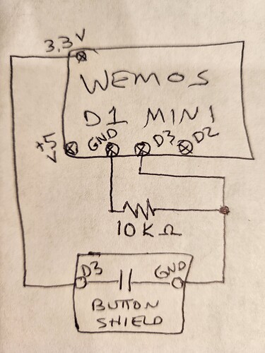

The attached pics show my wiring setup and example code for reading a digital input.
Is there any glaring errors to why the pushbutton input refuses to change state? Wiring has been triple checked and ohmed out. The LED actually works by a stroke of unbelievably good fortune. lol...

const int buttonPin = D2;
The diagram show the button wired to pin D3
Could that be a problem ?

Not according to reference info I found, including:;
I went ahead and tried D4 as well already. No change in problem.

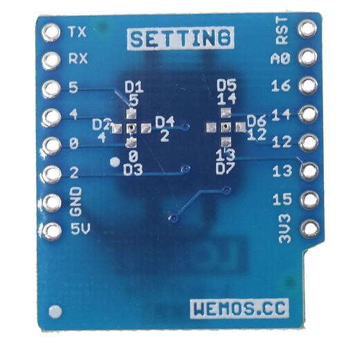

The "D3" on the button shield just mimics the Memos D1 board silk screening. The button shield actually has 16 pins w/ identical silk screening to the Wemos D1 even though only four pins are wired to the switch.

Does the back of the button shield look like this ?

Unfortunately I would have to de-solder it from the breadboard to be sure but this
link shows a pic of the back:
To be clear I did not use the button shield while testing all the dig inputs. I used a prototype breadboard with jumpers to recreate the wiring w/ a 10k resistor and switch.

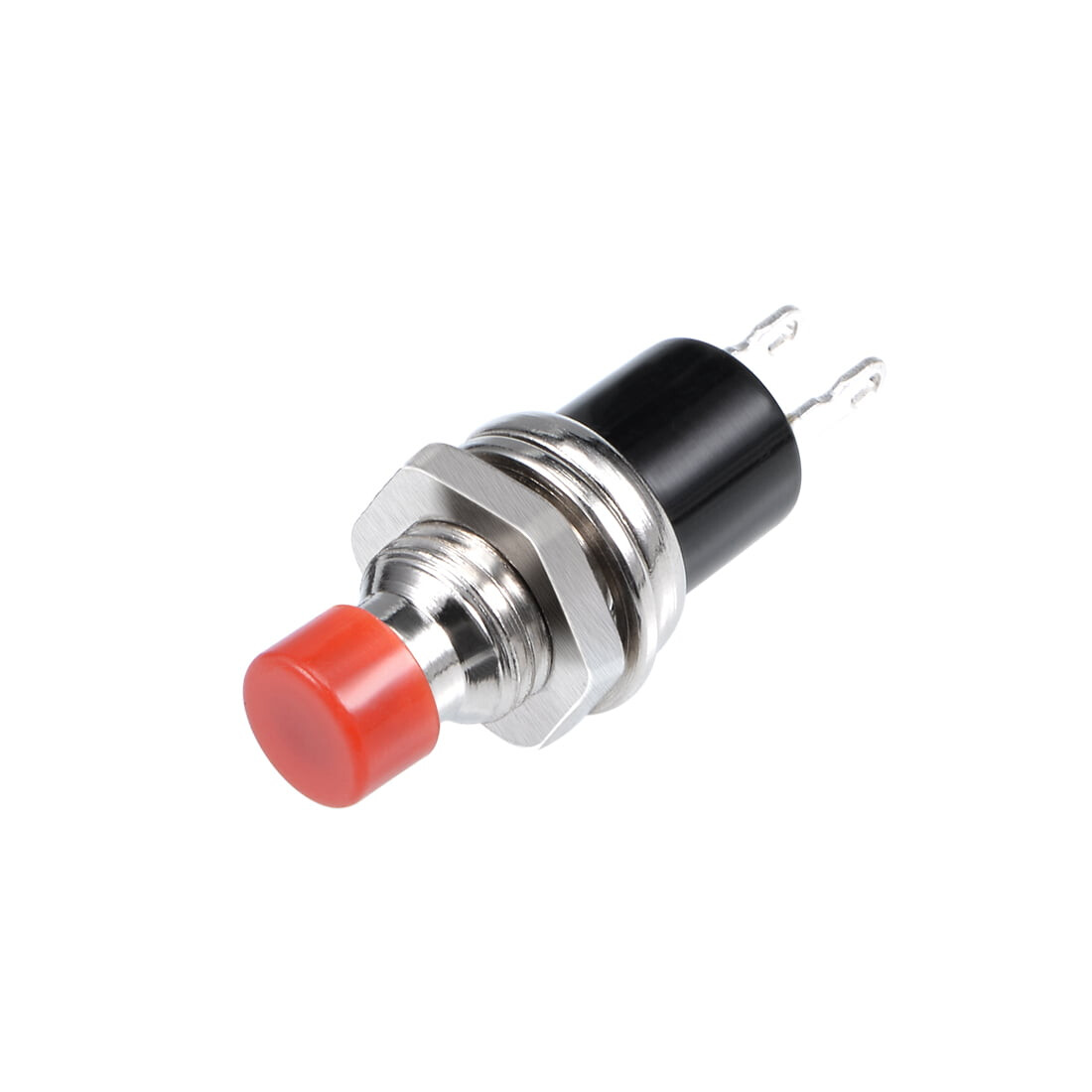

post a picture the buttons that you use
If it is one of these for pin buttons always two of them are connected to each other permanently

As previously stated I did not use the button shield to test all the digital inputs but a
prototype breadboard.
Yes, and yes.
I did measure the 3.3v sourcing the one side of the button shield switch and read the 3 v across the 10k resistor while the switch was made.
The RNT tutorial chart shows D8 as an input which is "pulled to GND" and was the only input that worked with the switch during my testing. If the other inputs are "pulled up" I wonder what is the correct wiring methodology for using them?

I did use the 10k resistor w/ one leg tied to GND an the other leg tied to the switch pin and the D8 input; 3.3v pin feeds the other side of the switch.
This is not the way it should be made.
A switch is not a device like a sensor that needs GND and +3,3V
If you use pinmode INPUT_PULLUP connecting the one pin of the switch to the IO-pin and connecting the other pin of the switch to GND is totally sufficient. If you start adding another resistor or connecting it to +3.3V you are disturbing the original circuit which only needs the pure mechanical switch.
A "switch" that requires to have an extra GND and an extra +3.3V connection is no longer a simple switch.

Did you use this mysterious button-shield
or did you use a very simple button like this for your testing?
