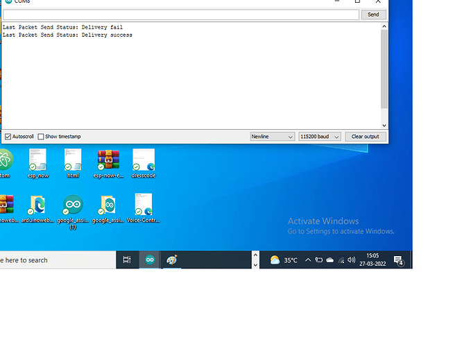

I have managed to connect the esp now controller a nodemcu HW to 2 slaves successfully. I want to integrate my app to my program, which is required to activate LEDs according to commands broadcast to the slaves. Will be helpful for any guidance. Thanks
Where are you stuck ?
If you have got the two systems communicating then you can send a command from one to the other and having received the command, test its value and act on it
the command I send is received but the program does not execute. thats my problem.
thanks.
Post the code of both your transmitter and receiver so that we can see what you are doing

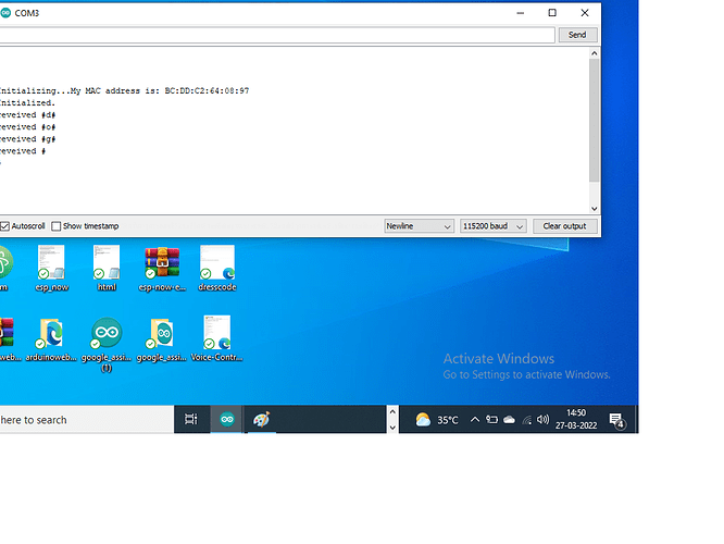

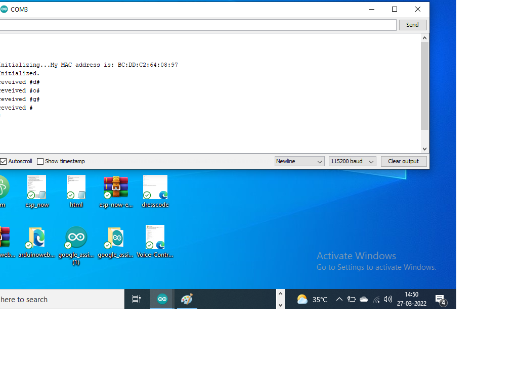

can you show a sample Serial Monitor output of the sender and the receiver?
why have you
exit(0);
in loop()?
I added exit in loop to stop the serial after executing command once
your command "dog" is being received as three seperate bytes
in receiver try
void readFromSerial() {
  while (Serial.available() > 0)  {
    char rcvdChar = Serial.readStringUntil('\n');
in the sender you will probably have add the '\n' back in
