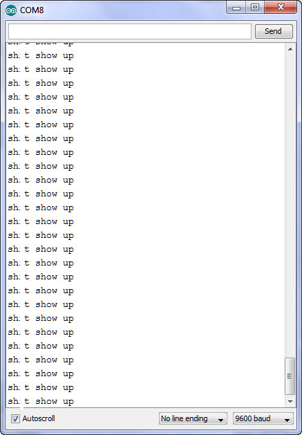

This is what I get
Is you serial monitor set to 9600?
Is you switch/ultrasonic wired properly?

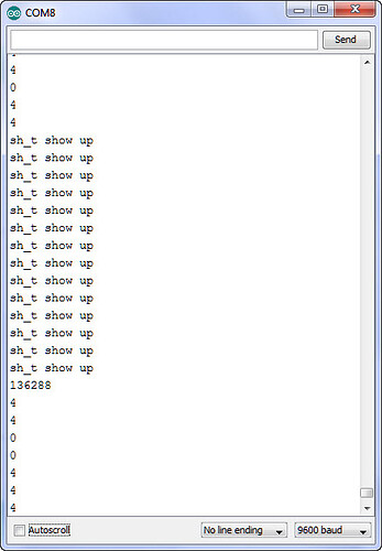

This is what I get if I push the switch

Looks like the ultrasonic is not give you an output

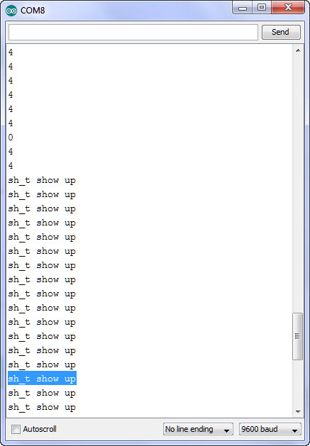

This is with the ! and me pushing a switch as described

Using a switch does display the time in uS when the switch is let go as seen in the image below
