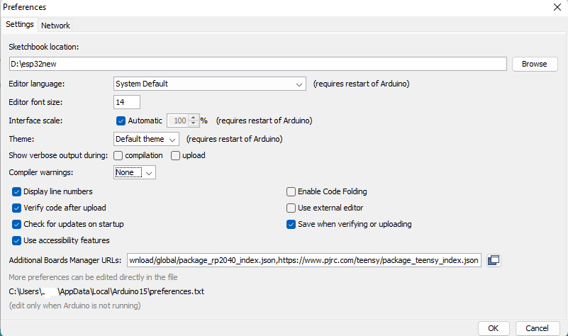

Turn on verbose compiler option in 'preferences', and compile blink.ino. Peruse the reams of information relating to the compilation process. You should find it there.

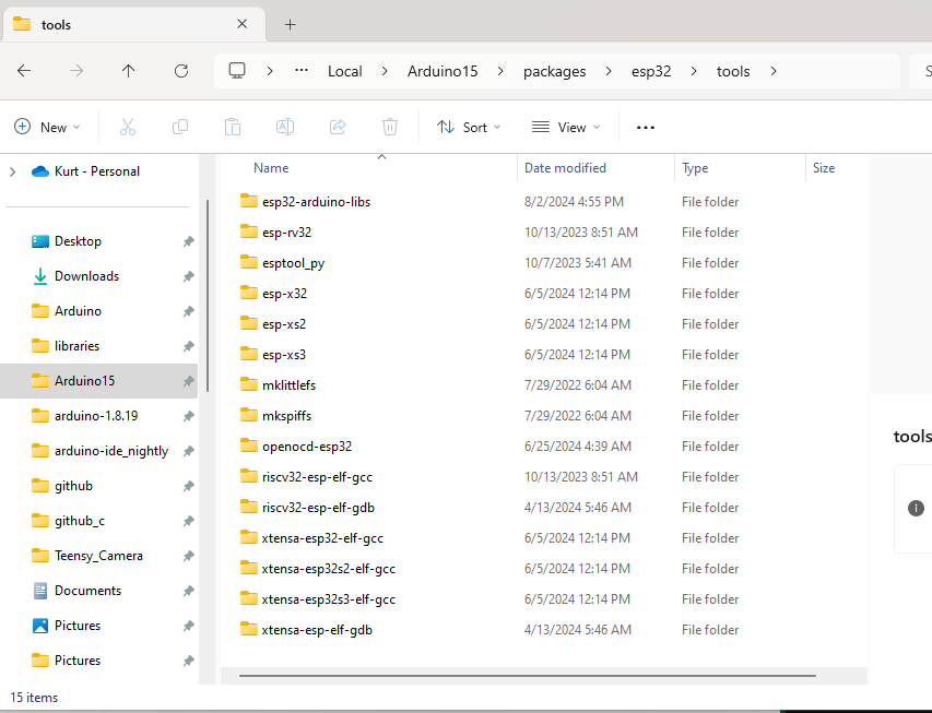

When you install a board, through the board manager, part of their board definitions includes which set of tools to install including which compiler:
Once the board is installed, the tools are stored in the Arduino15 directory...
Which for example for ESP32... you see, something like this:
Which on my machine is setup at: C:\Users\kurte\AppData\Local\Arduino15\packages\esp32\tools
As mentioned by others, which tools are used depends on the board type.
They specify a bunch of this information in their boards.txt and platform.txt which are
stored at the root of their hardware install. Again in my case for Esp32, that would be:
C:\Users\kurte\AppData\Local\Arduino15\packages\esp32\hardware\esp32\3.0.4

The best thing is to turn on verbose output: In the preferences dialog you showed,
the checkboxes for Show verbose output during... turn on at least compilation.
I tried to build something for a PICO-D4 and some of the compile lines looked like:
"C:\\Users\\kurte\\AppData\\Local\\Arduino15\\packages\\esp32\\tools\\esp-x32\\2302/bin/xtensa-esp32-elf-g++" -MMD -c "@C:\\Users\\kurte\\AppData\\Local\\Arduino15\\packages\\esp32\\tools\\esp32-arduino-libs\\idf-release_v5.1-b6b4727c58\\esp32/flags/cpp_flags" -Wall -Wextra -Os -DF_CPU=240000000L -DARDUINO=10607 -DARDUINO_ESP32_PICO -DARDUINO_ARCH_ESP32 "-DARDUINO_BOARD=\"ESP32_PICO\"" "-DARDUINO_VARIANT=\"pico32\"" -DARDUINO_PARTITION_default "-DARDUINO_HOST_OS=\"windows\"" "-DARDUINO_FQBN=\"esp32:esp32:pico32:UploadSpeed=921600,PartitionScheme=default,DebugLevel=none,EraseFlash=none\"" -DESP32 -DCORE_DEBUG_LEVEL=0 -DARDUINO_USB_CDC_ON_BOOT=0 "@C:\\Users\\kurte\\AppData\\Local\\Arduino15\\packages\\esp32\\tools\\esp32-arduino-libs\\idf-release_v5.1-b6b4727c58\\esp32/flags/defines" "-IC:\\Users\\kurte\\AppData\\Local\\Temp\\.arduinoIDE-unsaved2024718-38264-pxu9jl.xnure\\GetChipID" -iprefix "C:\\Users\\kurte\\AppData\\Local\\Arduino15\\packages\\esp32\\tools\\esp32-arduino-libs\\idf-release_v5.1-b6b4727c58\\esp32/include/" "@C:\\Users\\kurte\\AppData\\Local\\Arduino15\\packages\\esp32\\tools\\esp32-arduino-libs\\idf-release_v5.1-b6b4727c58\\esp32/flags/includes" "-IC:\\Users\\kurte\\AppData\\Local\\Arduino15\\packages\\esp32\\tools\\esp32-arduino-libs\\idf-release_v5.1-b6b4727c58\\esp32/dio_qspi/include" "-IC:\\Users\\kurte\\AppData\\Local\\Arduino15\\packages\\esp32\\hardware\\esp32\\3.0.4\\cores\\esp32" "-IC:\\Users\\kurte\\AppData\\Local\\Arduino15\\packages\\esp32\\hardware\\esp32\\3.0.4\\variants\\pico32" "@C:\\Users\\kurte\\AppData\\Local\\Temp\\arduino\\sketches\\C9A954706F78C6022EB510D2BE06D0F1/build_opt.h" "@C:\\Users\\kurte\\AppData\\Local\\Temp\\arduino\\sketches\\C9A954706F78C6022EB510D2BE06D0F1/file_opts" "C:\\Users\\kurte\\AppData\\Local\\Arduino15\\packages\\esp32\\hardware\\esp32\\3.0.4\\cores\\esp32\\Esp.cpp" -o "C:\\Users\\kurte\\AppData\\Local\\Temp\\arduino\\sketches\\C9A954706F78C6022EB510D2BE06D0F1\\core\\Esp.cpp.o"
