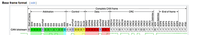

What kind of data structure to hold a complete CAN frame?
The simple datatypes based on multiples of 8 bits don't map well to something like this which has a head and tail containing fields of various lengths. (I think I can ignore the stuff and ACK bits as I assume they are added and removed by the CAN controller.)

A struct with bitfields will probably do.
struct CANFRAME
  uint64_t SOF:1;
  uint64_t arbitration: 13;
  uint64_t control: 7:
  uint64_t data: 9;
  uint64_t crc: 16;
In case you don't know, the numbers after the colons indicate the number of bits used by a field.
I'm not familiar with CAN bus; this is purely based on your image. Fields with stuffing bits will contain the stuffing but; you will have to do some shifting.
