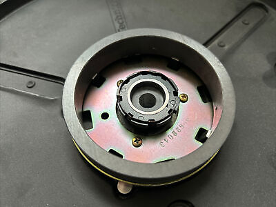

This is the main board, the motor is mounted onto the motherboard, and the driving circuit is on it.
The second pic is the motor coil with the plastic thing removed.
s-l400
This is the reverse side of the platter. This is the other part of the motor, it is part of the platter (though it can be removed, it's simply screwed on). When you press the start button the coils magnetize itself in a rotating magnetic field to cause it to turn. I didn't think it could turn backwards, but it can, it's just that the turntable isn't supposed to spin the wrong way but if something breaks on the motherboard, it can.
In fact one failure mode is that it has "runaway platter" meaning it will spin faster and faster until it spun as fast as it can possibly spin, and pressing any of the buttons do nothing, it just spins FAST as soon as it is turned on.

Here is a picture I found that explains the operation of the thing. It has a hall effect sensor to sense the position of the platter.
Do you suppose there's a standard inverter driver I can use to get it to spin independently of the board?
