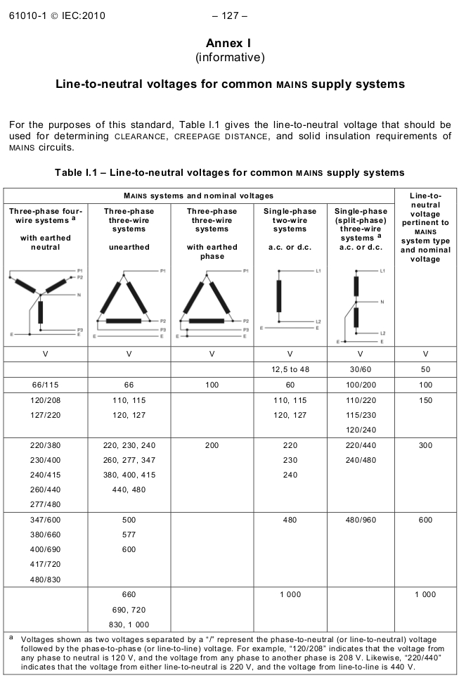

What should be the clearance and creepage for the line to line 440 Vac and line to neutral 240 Vac of the three-phase system on PCB?
Also is there any link to calculate this as per the UL and other industrial standards

If you are putting a product through regulatory approvals, you can afford to buy the relevant safety standard and consult with UL. The actual spacings requirement depends on many factors.
The pollution degree- is the board in dirty, dust environment or moisture present? Is the product grounded on the secondary side? What altitude?
Because mains voltages are subject to transients, extra spacing is demanded in the safety standards. If the power source is close to the distribution network (transformer) Overvoltage Category III or IV applies.
Many Smart Meters arced over and caught fire (house included) because they are in Cat. IV and bad designs are out there.

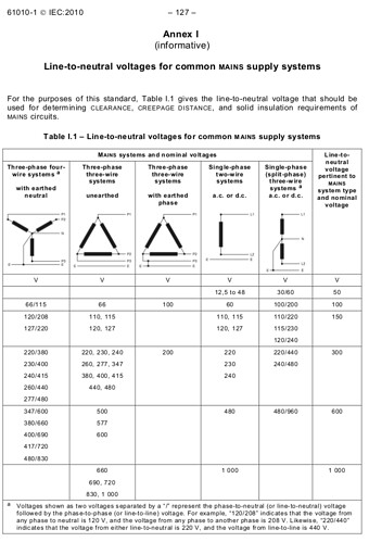

Attached shows mains power system types which implies you are in the nominal 300V range.
Generally speaking, IEC 61010 for 300V Cat. III is 3mm (Cat. IV is 5.5mm) on PC boards, and that or double that to the secondary side depending on the product's safety strategy i.e double insulated.
Cat. IV 300V is an 6kV test so any voltage sense resistors and terminal blocks etc. need to take that. There is also spacings on PC board inner layers if you are multi-layer.
I'm quoting numbers out of a hat only so you have a rough idea - UL engineers will advise accordingly. I overdesign because transients can be more than average.
