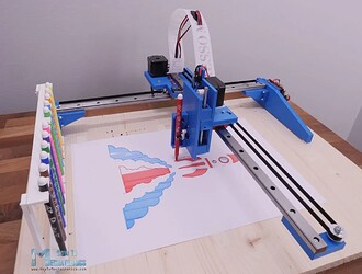

Hello all,
I would like to create a COREXY CNC Pen Plotter.
I'm planning on using an arduino uno with a cnc shield, to grip the pen a small servo motor and for the XYZ movement, I will use 3 nema 17.
I have 2 criteria I need to fill.
That is automatique tool change like this :
And to be able to apply preasure, for calligraphique writting like so :
So then, the question I have is what software should I use to combine all of this?
Thank you all. :slight_smile:

The small servo is for gripping and ungripping the pen. Then 1 nema 17 for X, 1 nema 17 for Y and another for Z.
Is that clear?
To upload on the arduino, I found GRBL, that is quite commonly used. So that would fit I think so. But I still need an UGS (Universal G-Code Sender).
Okey, automatic "tool change". I missed that. A little stepper and a spring might be more easy to operate, not punching holes in the paper.
Know that NEMA17 tells nothing but the mounting face of the stepper... Use M3 screws and a specified distance between the holes...
