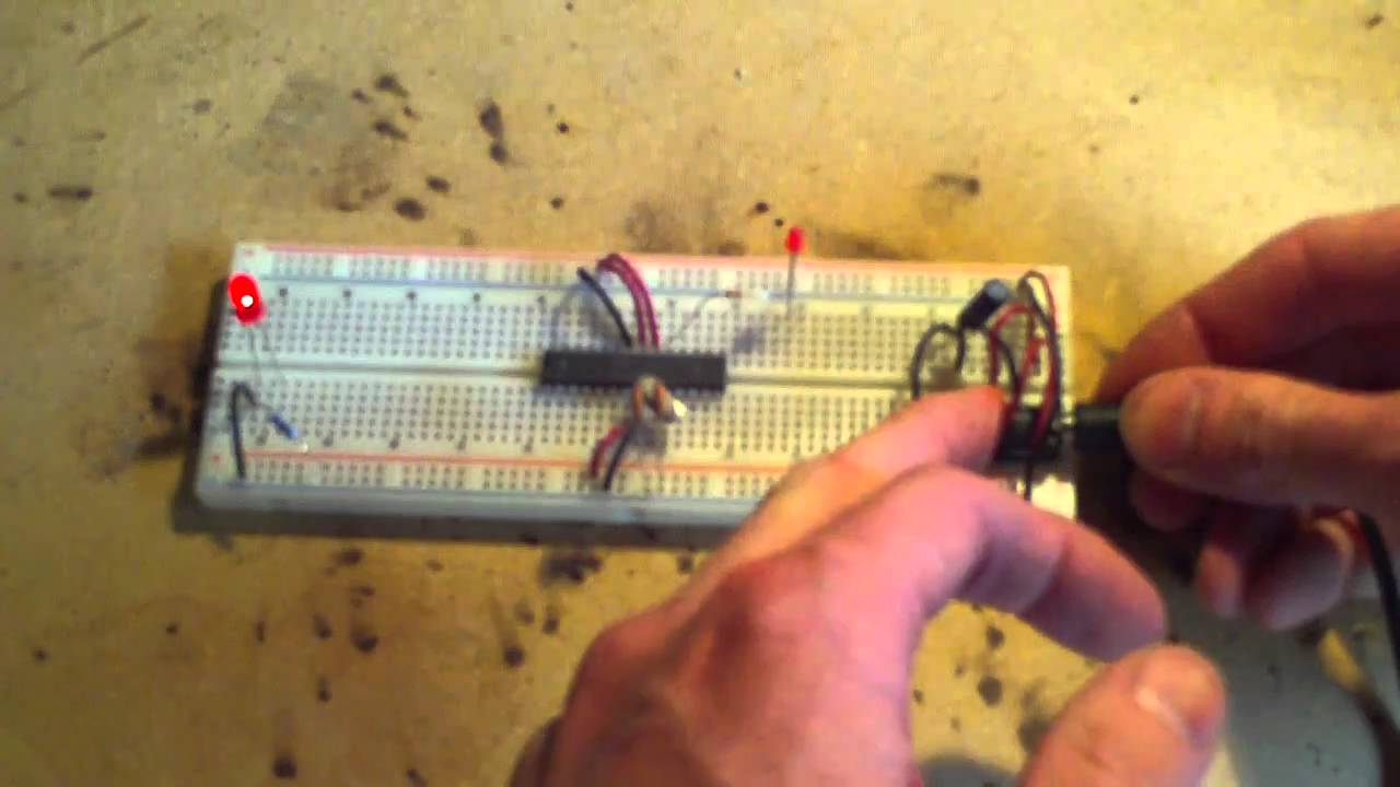

I don't know why there is such a delay in my Arduino executing code. On my actual Arduino Duemilanove board, it turns the LED on instantly when I supply power to the Arduino Duemilanove board. However, on my standalone circuit, as you can see in the video, it turns on real briefly, then turns off for a couple seconds, then finally turns on.
Video demonstration:
As you probably can tell, the larger LED to the left is connected to power directly, not the Arduino chip. And sorry for the blurriness.
Do I have the capacitor hooked up right?
The reason I'm asking all of this is because my next project is going to require instant code execution upon power being supplied to my circuit.

1 Is is the bootloader - perhaps you could modify it, or program without a bootloader
2 You have nothing connected to the reset - I thought there is supposed to be a pull up.
This is the standard 1 second bootloader delay - I would expect the Duemilanove to do this too unless a non-standard bootloader is installed on it. Perhaps you have optiboot on it?
