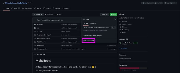

You download a zip archive of the library and then follow these instructions.
