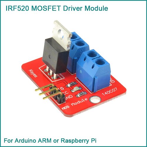

how 'bout this?
Noobian:
how 'bout this?
Rubbish, it is not a logic level FET so why it is marketed for an Arduino or Pi is anyone's guess. You need 10V on the gate to fully turn it on and even so the on resistance at 0.27R is rubbish these days.
