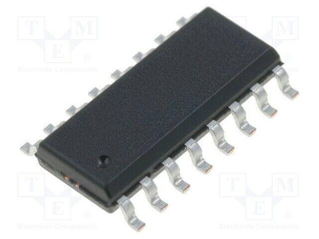

The same chips can come in different packages. For soldering to prototype PCB (stripboard, veroboard, Protoboard, tri-pad board etc) you need to buy the chip in a package with thu-hole pins on a 0.1" grid. These are often called "DIP" or "DIL" chips.
The DIP/DIL package:
SMD package (no good for protoboards):

As a beginner, it may be safer to use chip sockets.
I prefer sockets instead of direct soldering of PTH chips.
Any chip with PTH (DIL) pinout. For 16 I/O lines with SPI or I2C look up port expanders.
