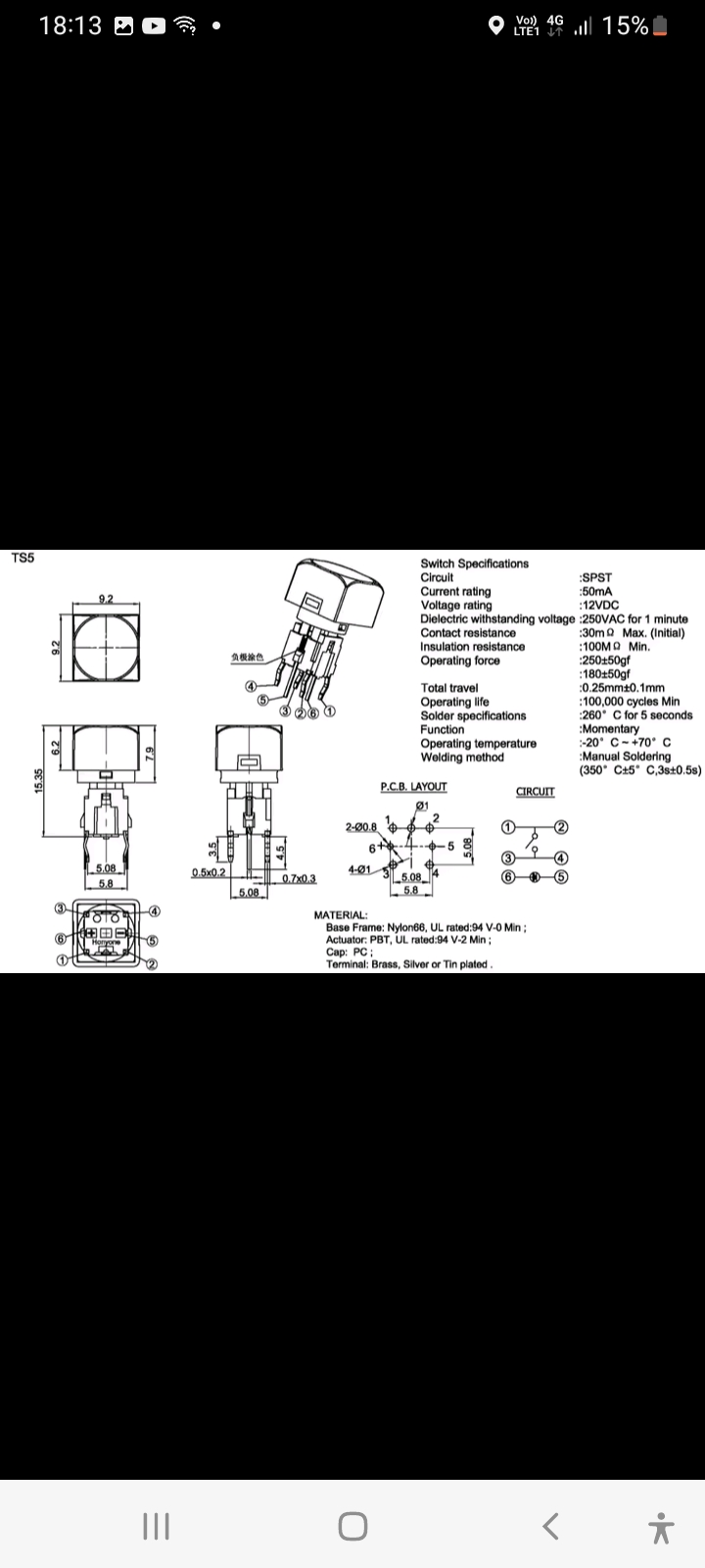

they are 12V buttons - how did you wire/power them ?

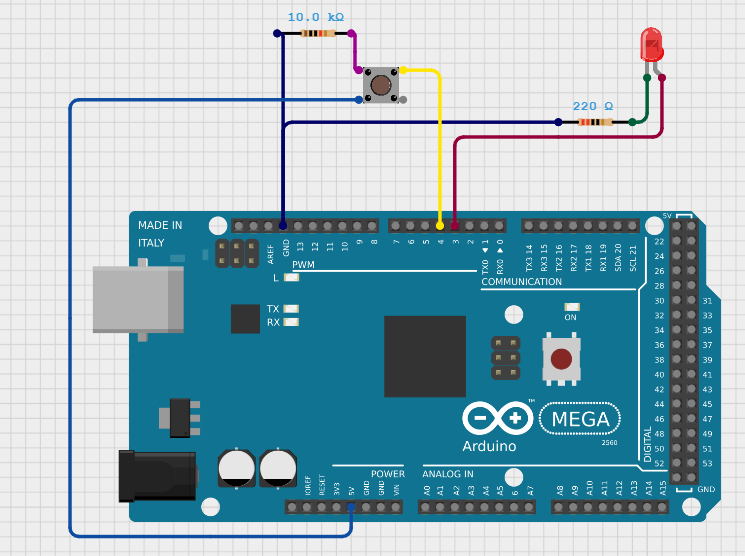

Just like normal led and push buttons... with a 10k ohm resistance for the buttons and 220 ohm resistance for led... the whole one the 5 V...
It false i know but it's work... should i change something ? It's dangerous for the mega ?
Yes all 25 leds are connected to 25 pins with a 220 ohm resistance in serie. But i don't know how i can know the mA use by them...

Post a simple schematic showing exactly how you have wired this and how it is powered. For the LEDs and Buttons you only need to show a few but note each pin. Also note what color LEDs you are using such as REd, Green, ..etc. and how many.

Switches (buttons) are best connected between pin and ground, with internal pull up enabled on the pin. That way you won't need any resistors for your switches either.

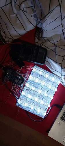

the 25 are all connect like that and the mega is powered by usb in PC.(and the led are white)
I do that... I have 0.19 A => 190 mA when all led are "ON" it's ok ?
:warning: trigger warning (I will post a picture of my project... :warning:
