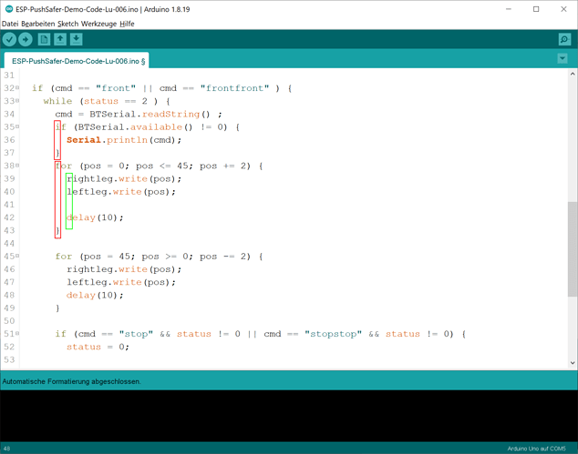

One delay you got is 2(delay(10) * the number of loop iterations) and another delay is Serial.println(cmd).
well done posting the code as a code-section.
There is another thing that you should follow.
press Ctrl-T
for autoformatting the indentions of the code
Your code with improper indentions
After
pressing Ctrl-T
the autoformatted code looks like this
The closing brace is in the same collum as the "i" of if in the same columm as the "f" of the for
until now your style of learning programming seems to be head fast forward
trying different things until it works.
This means your knowledge about the functions that you use is rather small.
If you look up the documentaion of the function readString()
You can read there that the function readString() has a timeout
calling readStr() wais for a complete string to be received until the line-ending character is received or if the timeout-waitingtime is over
Your coe will aöways react immidiately after you have learned
  • what non-blocking timing is and how it works
  • what state-machine are and how state-machines work
  • writing your customised serial receive-function derived from robin2 serial input basics
You can invest 100 hours into trying this, trying that
and after these 100 hour still not really knowing how to code it
or you can invest 30 hours of time to learn the things mentioned above and have a quick-responsive code
it is up to you to decide which way to go
best regards Stefan
