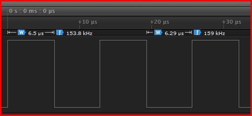

You must be doing something wrong, here is what I get:
LarryD, is that using my sketch or your sketch and which Arduino?
Your sketch did make the HIGH and LOW signal times the same. Unfortunately, they are both now 11.7us. The goal really wasn't to make the HIGH and LOW signal times the same but determine why directly writing HIGH and LOW takes different amounts of time.
Adding the significant CPU cycle overhead of digitalRead-ing what I was tracking via the static integer wasn't what I had in mind but thanks for the cool snippet for future use.
Your sketch.
UNO
It could be the cheapo UNO I have.
I grabbed another one that I was using elsewhere. Now, it is quite close to symmetrical: 7.4 to 7.6
Oops. Thanks for your help! :slight_smile:
