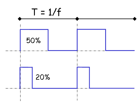

Another issue that “torments” me is this: how do you handle the case where the LED is powered by a PWM signal whose average (measured) voltage is 1.7V, even though the absolute voltage varies between 0 and 5V?
well pwm signal can imaged as a square wave,
something like that
this signal can assume only two values (HIGH and LOW), usually this two values are set to VCC and GND (where vcc can be in you case 5v)
no other values are allowed in this signal (well, there is a transiet from vcc to gnd so we can don’t takes care of it)
since this is a MODULATION (PWM means Pulse-width modulation), you use this to generate a various range of signal,
usually the range beetween VCC and Ground.
image to have a switch, and you can turn on/off ti very faster (where very faster mean at a frequency of 1000hz, so 1000 times in a second)
you can also define a basic-period called duty cycle. And you calculate total time the switch is on inside the duty cycle:
at the end you will have:
ONtime + OFFtime = dutyCycletime.
and the % of the Ontime is set to: (ONtime/dutyCycletime)*100
fo ie: you turn it on for 2 second inside a 10 second dutycycle , you can say that it’s on for the 20% of time.
so where is the magic…
Some system are not so faster-frequency response able, like our eyes that can only handle 30hz (this is the reason why we don’t see the normal AC light flickering)
PWM over led are equal: you let the led turn on and off master, and off course your tester dosn’t take it as a faster +vcc/gnd sequence but just take it as the VCC * % (over calculated)
so for you or for your tester is a sort of avarange measure, but for your led, that is faster enought to light on and off, is only a quickly sequency where sometimes there is 5v, and sometimes no.
so in case the pwm is HIGH you need the resistor as always… so at the end:
if you controll a led with a constant signal (V) you need to put a resistor to takes care of the current draw,
and
if you controll a led with a PWM signal (Von/Voff) you need to put a resistor to takes care of the current draw in the HIGH part of the wave lenght
