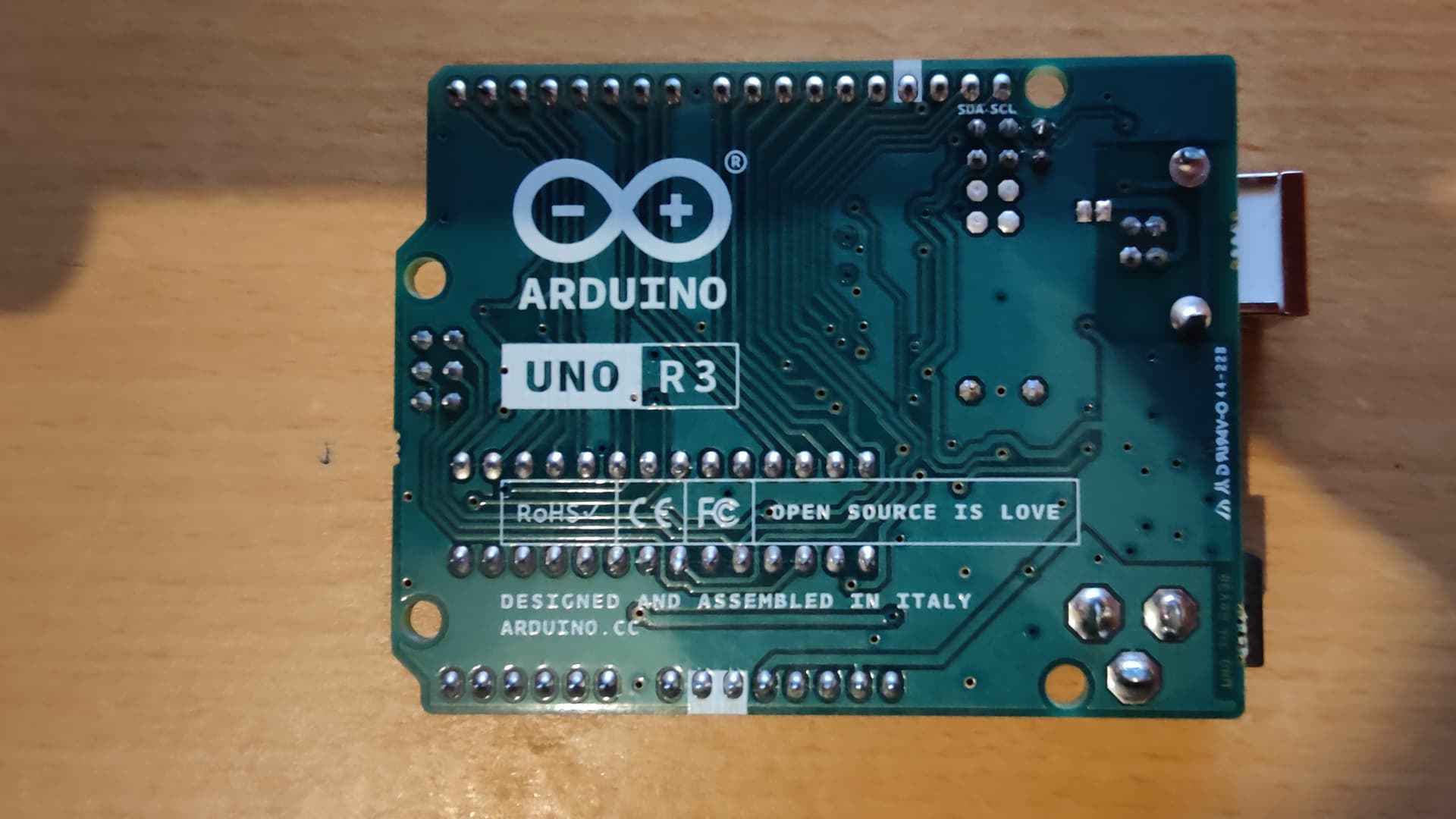

Why is the serial monitor only outputting a few lines?
Hello,
I'm have written some code for the Arduino, where it receives a value from a python script over serial. It's then supposed to compare this value to a running total of encoder pulses, when the encoder pulses exceed this value the motors should stop running. I'm yet to integrate them motor part, that's the next step. I'm having an issue where the Arduino reaches the comparison while loop, in this loop I have it printing some information to the serial monitor for debugging - the issue is it only prints 4 or 5 lines before the output stops and the information it outputs is strangely formatted.
I have no idea what I'm doing wrong.

Heres an example of the serial monitor output (mind you it changes every time the codes run):
20:49:39.384 ->  Running R
20:49:39.384 ->  Runniotal pulses:0	 Target pulses:200
20:49:39.384 ->  Running Total pulses:0	 Target pulses:200
20:49:39.384 ->  Running Total pulses0	 T

Thanks for the code appreciate it. Unfortunately still having the same issue, here's the serial monitor output when I run your code:
09:52:37.239 ->  Running Total pul0
09:52:37.239 ->  Running Total pulses:0	 Target pulses:200
09:52:37.239 -> 0
Please share with us,
  • what Arduino device - Nano, Uno, ESP32, ???
  • simple schematic; include power arrangements, what's generating the interrupt, how fast, etc., what motor control arrangement.
When you don't know what the problem is, don't assume "it isn't ..." and therefore limit what you share with us - because you don't know what you don't know. Yes, some sharing may result in 'critique' or 'helpful advice'. That's part of resolving the issue.
Thanks for you response!
There really isn't much more too it. I'm using an arduino mega 2560, but have also attempted to run the script on a nano (no success).
I plan on using pololu 37d geared motors which have a built in encoder. I haven't bothered wiring them up yet, I can't see any point if the serial print can't even relay information from the encoder. So the wiring schematic is a serial connection with my laptop over USB-B. I will share the script I'm running on my laptop when Im home.
Hope this helps.

Well, with the code tested successfully elsewhere, I'd focus on mechanical issues.
  • bad cable (likely, as an intermittent might behave when you download, but fail when you move the board around, or whatever)
  • board lying on conductive surface, intermittently causing crashes
  • damaged Arduino (not likely, can't think of a suitable case, but...)
    All I can come up with without a photo or other evidence to investigate
I'll grab some photos when I'm home, but as I say I've tested it on an uno with the same results. I've got to be doing something stupid....

I've tried using a different cable, no success. The Arduino's in a plastic case and not near anything conductive, so I doubt that's an issue.
Photos:
