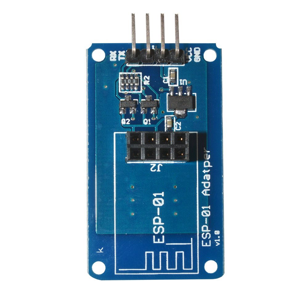

I'm presently connecting an ESP8266-01 wifi module to my UNO for testing, and all is operating using AT commands. My own test uses SoftwareSerial Serial1(6, 7); // RX, TX so I know exactly how the ESP8266 connects.
Now I'm trying to get a couple of the included example WiFi sketches to work, but they give no indication how things are connected, and they don't employ SoftwareSerial ports. I tested with the wifi connected to 0 and 1, but didn't work. Should it?

What about signal level translation? Baud rate? Please show a diagram of your electrical connections (especially after the statement "no pinouts given").

My original question is asking about understanding the data lines of the wifi example. My logic levels are matching, baud rate all at 9600. I'm familiar with logic level conversion and baud rate requirements.
I don't have a diagram Of my own, but this is similar, except I use the below module. And external power.
(for serial com references only)
I use this ESP8266 adapter module that handles power and logic levels.

Have you tried simple AT commands, using the SerialPassthrough sketch, for example?
As I stated in my original post, I have tested the EPS8266 adapter using AT commands in a sketch using Software Serial pins 6 & 7 and its working fine.

I think the library you're using is meant for a WiFi shield that connects to the Arduino via SPI. You need to use one specifically meant for ESP8266 (with AT Firmware not reflashed by Arudino IDE) connecting via serial.
