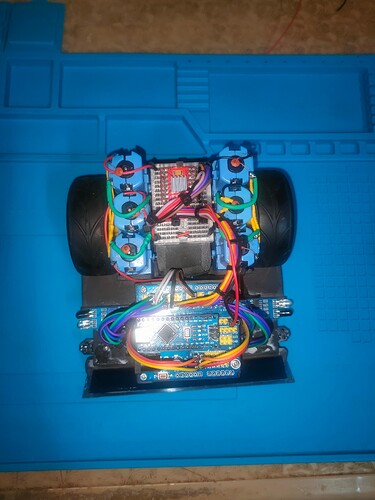

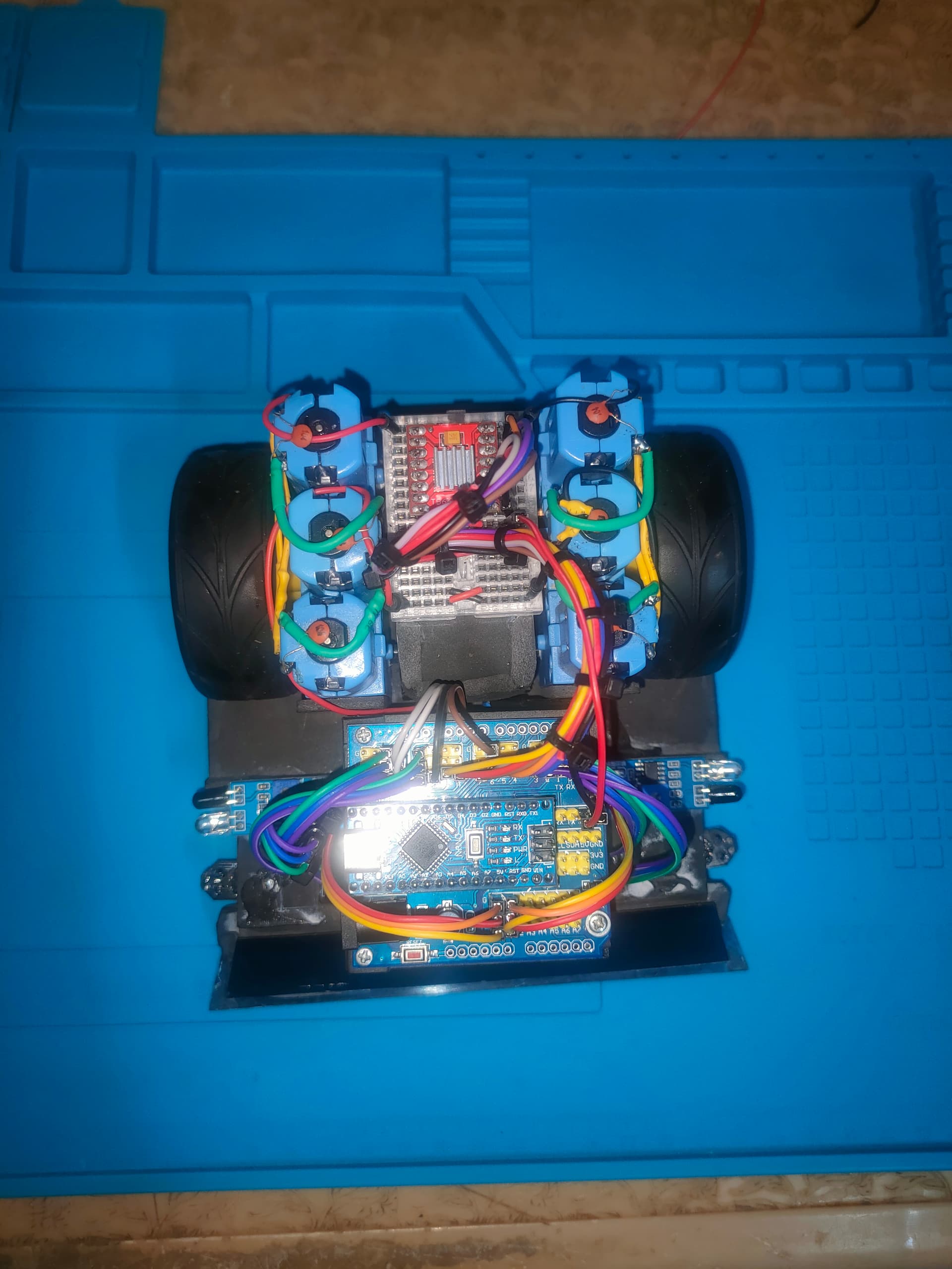

Will this circuit work? For SumoBot Project
I have a TB6612FNG Motor Driver, power supplied by a boost converter from an 18650 battery. The boost converter was set to 11.5V with peak currents of 2A. There are three TT 130 geared brushed motors on each channel with a stall current of 200mA each motor. So there are 6 motors in total and that should only be around 1.2A to be provided to the motor driver. The problem is the the motor driver is only consuming at most of 0.3A, so the motors are very slow and weak. I even installed a heatsink to it, those used on raspi. What could be the cause of this?

No problems so far when it comes to the motors apart from weight. Directly powered it with a 9 volt battery and it was working fine. I deduced that the motor driver is the only bottleneck left to fix.
The gears used are herringbone gears. At first it was just spur gears but was met with synchronization and slipping issues.
I agree. The heatsink was barely warm. Sign that there is less current draw.
Tried 5V to 12V (motor driver max V: 13.5) and still weak spins. The current draw were just 0.3A or less.
I'm starting to think that all the power supply problems might not be the root of this. It was working fine back when the TB6612FNG was directly powered by two 9V in paralelI, no boost converter. Here's the vid. The code was simple, 5 sec forward and delay.​​
Lo and behold. It was indeed the motor driver TB6612FNG. Tested the bot with the DRV8833 and it is working fine. Test Vid, the code was copied from gh.
From what we can observe on the vid, on 9V, the activation current on a single channel can be up to 0.7A, then settles to around 0.6A. The DRV8833 has a continuous output current of 1.2A per channel (some says 1.5A), 2A (per channel) peak output current.
Although it is less efficient than the TB6612FNG, it will suffice and I've installed a heatsink.
The 9V will be set aside and it will be powered with an 18650 through a boost converter. Although heavy, it would be beneficial if it was close to 600 grams. Hopefully this is it so I can start programming along with its sensors.
