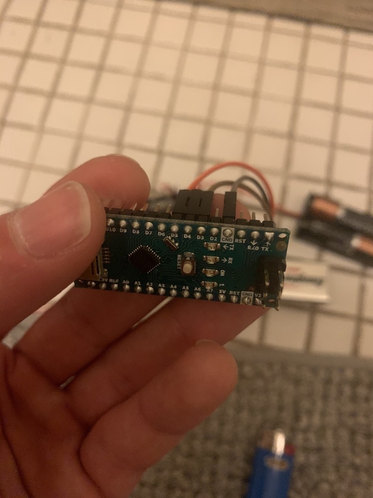

Just got home from work, quickly posting some photos to help you guys out, and sorry I knew that the wording wouldn’t help but I didn’t have a minute to get the pictures together at the time. Thanks for all the replies.
Shows the project, batteries I’m using as well as the two left-most ports I’m putting the ground and power supply to. Also where the motors are connected and the connections on the Arduino. The Arduino ground I have connected is going to that center port of the three ports shown where the batteries go into. I also showed the other GND and VIN ports on the Arduino nano I put the 9V into before it started heating up. Going to read over some replies before dinner.
Can’t figure out how to display the pictures within my post without redirecting. 6 photos.
OPs pics.

So.. in the video Tom posted it shows a guy using 4 AA batteries... and he states that it’s 5.3V... 1.5V per AA battery minus whatever is lost in all the transferring or whatever.... so why wouldn’t a 9V battery be able to power the motor......
I’m not even planning on powering it for long I’m just testing things out. I plan on using way smaller motors once I find some.
Also thank you Tom for sharing my photos I was struggling for a minute there lol. I’m looking closely at this video to see where I’m going wrong.
My goal is to just to get the Arduino to turn on and test the motors without using a USB. I’m probably going to copy and paste some coding as needed to get a successful test run, but I just need this LED to light up by the on button on the nano first... without USB
Even with using the 9V on the L298N on it’s own in the ground and regular shouldn’t it light up?
