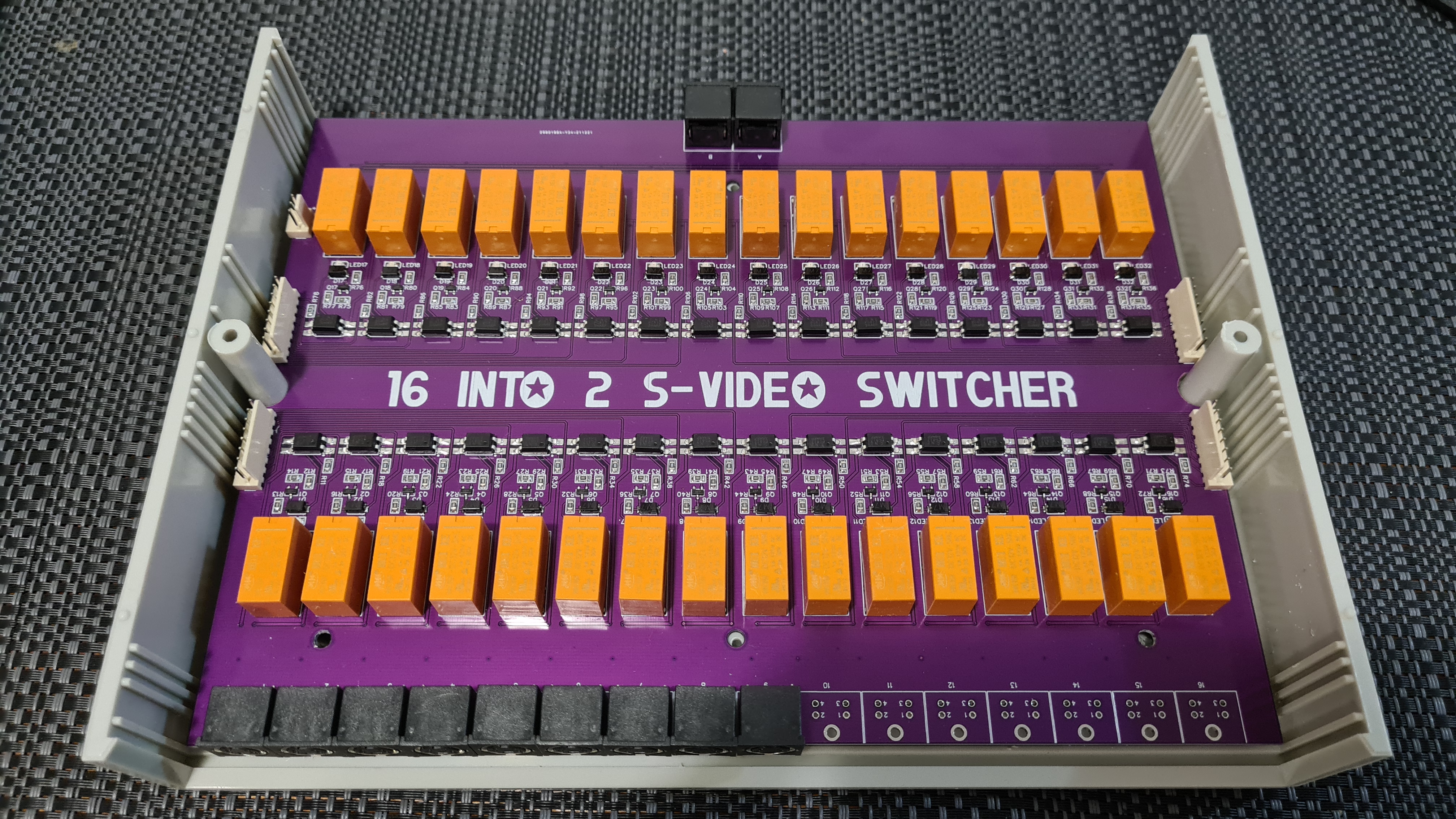

My end goal is to take an S-Video signal (converted from RGBS) from 16 arcade cabinets and choose any two cabinets via a phone or tablet to feed into a Twitch stream for the Australian Kong Off (Donkey Kong ) competition.
I started with an Arduino Uno (Wifi) and connected it to an Arduino compatible 8 Channel Relay Board and followed the instructions on the related project in GitHub and all worked fine.

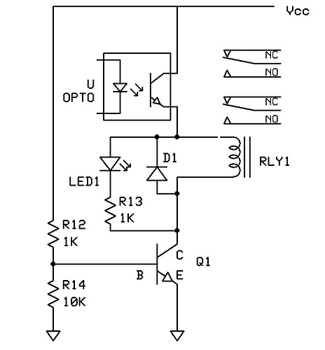

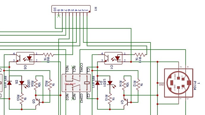

My issue is that I need to expand the project out to 32 relays to control the PCB I have built.
The are 16 rows of two relays, the first relay turns the input on and the second relay selects either channel A (normally closed contacts) or B (normally open contacts). At any one time there will only be three relays turned on.

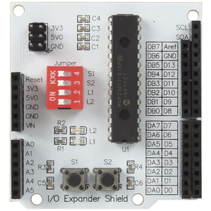

I have spent a couple of days trying to get the 8 Channel Relay project to work on the Mega without success, any thoughts?
I have a feeling it has something to do with the serial ports i.e. the Mega has 4 and the Uno only has one??
Please post a link to where you bought it from so we can be sure we understand what it is.
From the project link, it looks like the original "Uno (Wifi)" you mentioned is this board:
https://www.jaycar.com.au/uno-with-wi-fi/p/XC4411
Is that correct?
Yes, both bought from Jaycar and both Uno and Mega have onbaord Wifi.

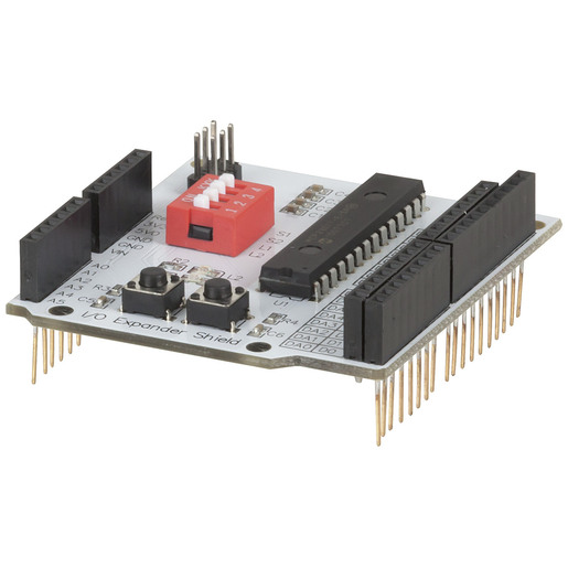

Did you look for an I/O expander to use with the UNO?
There was one available from Jaycar (Expander I/O Shield for Arduino/Pcduino) but it only expands by 16 pins, I needed a total of 32 so I'd be short by at least 2 pins.
This from Jaycar;
I think ou can stack them and have 32 I/O, they are I2C and by the looks of it you can set each shield address there own address.
Personally I would be constructing a vero/strip board module with 2 x MCP23017, to give you 32 I/O.

Kaizen, you have failed to give us the schematic - at least the individual module circuit - for your switcher. Can't say I would use relays for this if I were to do it, but we need to know how you propose to connect port expanders and such to your board; does it have driver transistors for the relays?

This is one of the individual module circuits used to switch the relay.

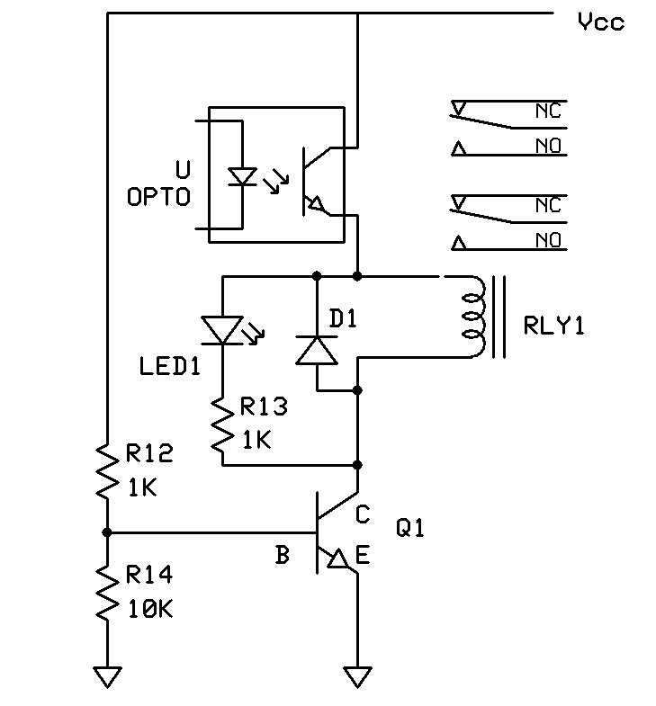

Just looking at your schematic and rearranging the layout;
What is the function of Q1?

Yep, that is indeed it as shown - which is total nonsense!
That would be completely unworkable. Even if we accept a drafting error and the optocoupler is actually in the base circuit of the transistor, if the optocoupler diode cathode is connected to the same negative "ground" as the transistor, then any "isolation" provided by the optocoupler is quite meaningless. :roll_eyes:

After looking at what you said, I agree there is no isolation however the relay is only switching an S-Video signal and not dangerous high voltage so it's not an issue in this instance. The circuit has been tested and it will switch the relays on nevertheless.

That is not the issue. The issue is that circuit - if it is truthful - is nonsense! :worried:
Can you post link to spec/data of the relay?
Can you post link to specs/data of the Opto?
What voltage is Vcc?
Who designed the circuit?

Hi, I am confused.
The circuit you posted in post#12 is to interface with this board?
OR
Is it this board?
