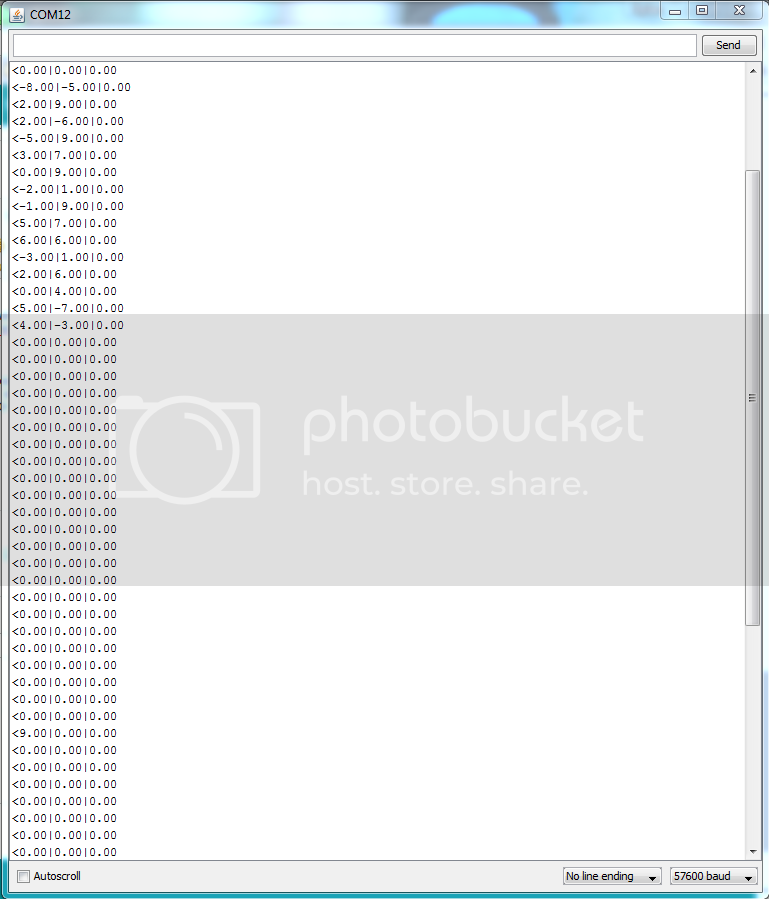

My Findings
I have two air modules (No USB connector) and one ground station module (USB connector). If I run the joystick module independently from the computer with its own power and I use the ground station module in my computer and I open up the serial terminal with the correct baud rates I get flawless results. I can see the values being stored in the array change as I move the joy stick. The same result when I use the second air module with a FTDI/TTL tool. So this tells me that the radios are paired correctly.
Now, when I bring the Ground Station into the mix is when things go wrong. The two air module pair well and I can see that they are communicating because the communication LED's are flashing. From what I can see, I have the data being written into the storage array but it is not being constisent, see attached a screen shot of the serial terminal output. When it does write data to the array, it is in the correct form, ie. 0.00 | 0.00 | 0.00. But if I move the joystick it remains this, thus I am losing something somewhere.
Mobile Station serial terminal screen grab:
So this is what is being transmitted. Notice the changing values due to moving the joystick.

My Suspicions:
I have a feeling that the two culprits are either my receiving loop or that the transmission is simply too fast. Having said that, if I put a two second delay on the joystick reading sketch and I still don't get values that are changing as I move the joystick. Or could it be my general approach to wireless serial transmission?
Any help or assistance would be much appreciated and if you have any questions, please don't hesitate to ask.

And this is the result I am getting when I open up the serial terminal:
| 0.òâ‚rª‚bj‚r²b‚rŠŠòâ‚rª‚bj‚r²b‚rŠšòâ‚rª‚bj‚r²b‚rŠšòâ‚rª‚bj‚r²bÿK“iªbj‚r¢Âb‚rŠšòâj¢rª¢bj‚r²Êb‚rŠšòâj¢rÂÊbj‚rÊšb‚rŠŠòâjªr’¢bjŠr’Šb‚rŠšòâjªr²’bjŠršºb‚rŠšòâjªrʪbjŠr¢ºb‚rŠšòâj²r’ªbjŠrÂÊb‚rŠŠòâj²r²šbj’r‚Šb‚rŠŠòâjºr‚‚bj’rŠºb‚rŠšòâjºrª‚bj’r’²b‚rŠŠòâjºrÊ¢bj’rª‚b‚rþ13><-8.43,-2.78,0.13><-8.86,-3.06,0.13><-9.11,-3.67,0.11><-9.09,-3.58,0.13><-9.11,-3.74,0.13><-9.11,-4.12,0.13><-9.11,-4.35,0.11><-9.11,-4.73,0.13><-9.14,-5.34,0.11><-9.14,-5.08,0.11><-9.14,-5.27,0.11><-9.14,-5.55,0.11><-9.16,-5.99,0.13><-9.14,-6.35,0.13><-9.11,-6.79,0.11><-9.00,-7.19,0.11><-8.79,-7.59,0.11><-8.55,-7.96,0.11><-8.32,-8.32,0.11><-7.99,-8.60,0.11><-7.78,-8.93,0.11><-7.61,-9.28,0.11><-7.45,-9.47,0.11><-7.24,-9.63,0.11><-6.96,-10.19,0.11><-6.70,-10.48,0.11><-6.35,-10.76,0.11><-5.83,-10.85,0.11><-5.17,-10.90,0.11><-4.47,-10.90,0.11><-3.55,-10.90,0.11><-2.71,-10.87,0.11><-1.96,-10.80,0.11><-1.23,-10.64,0.11><-0.60,-10.50,0.11><-0.34,-10.45,0.11><-0.15,-10.38,0.11><-0.04,-10.38,0.11><0.06,-10.22,0.11><0.32,-10.08,0.11><0.55,-10.03,0.11><0.81,-10.08,0.11><0.93,-9.26,0.11><1.07,-9.77,0.11><1.26,-9.65,0.13><1.54,-9.16,0.11><1.89,-7.66,0.11><2.26,-8.55,0.11><2.69,-6.53,0.11><3.13,-7.78,0.13><3.60,-7.38,0.11><4.02,-5.95,0.11><4.33,-6.30,0.11><4.66,-5.88,0.13><4.89,-5.17,0.11><5.01,-4.40,0.11><5.01,-4.23,0.11><5.01,-3.70,0.13><5.01,-2.52,0.13><5.03,-2.40,0.11><5.06,-2.05,0.11><5.06,-2.29,0.11><5.03,-1.56,0.11><4.99,-1.70,0.11><4.82,-1.35,0.11><4.63,-0.74,0.11><4.26,-0.79,0.13><3.77,-0.36,0.11><3.25,0.08,0.13><2.69,0.20,0.11><2.03,0.34,0.13><1.18,0.36,0.13><0.46,0.36,0.11><-0.29,0.36,0.13><-0.74,0.62,0.13><-1.02,0.79,0.13><-1.16,0.81,0.13><-1.40,0.88,0.13><-1.72,1.07,0.11><-2.19,1.26,0.11><-2.94,1.30,0.13><-3.84,1.21,0.13><-4.61,1.33,0.13><-5.67,0.48,0.13><-6.82,0.72,0.13><-8.13,0.22,0.11><-9.37,-1.47,0.11><-10.31,-1.04,0.11><-10.45,-0.62,0.11><-10.43,-0.50,0.11><-10.43,-0.41,0.11><-10.45,-0.29,0.11><-10.62,-0.60,0.11><-10.78,-0.74,0.11><-10.85,-0.97,0.11><-10.90,-1.42,0.11><-10.90,-2.29,0.11><-10.90,-2.05,0.11><-10.85,-2.45,0.11><-10.76,-3.01,0.11><-10.48,-3.62,0.11><-9.98,-4.30,0.11><-9.63,-4.38,0.11><-9.28,-4.94,0.11><-8.83,-5.24,0.11><-8.57,-5.92,0.11><-8.27,-6.46,0.11><-8.04,-7.21,0.11><-7.78,-7.96,0.11><-7.64,-8.65,0.11><-7.47,-9.37,0.11><-7.05,-9.94,0.11><-6.74,-10.40,0.11><-6.28,-10.94,0.11><-5.62,-11.13,0.11><-4.68,-11.34,0.11><-3.67,-11.41,0.11><-2.55,-11.39,0.11><-1.54,-11.44,0.11><-0.67,-11.23,0.11><-0.18,-11.13,0.11><0.06,-11.37,0.11><0.15,-11.48,0.11><0.27,-11.55,0.11><0.46,-11.55,0.11><0.76,-11.58,0.11><1.18,-11.48,0.11><1.91,-10.97,0.11><2.69,-10.73,0.11><3.51,-10.97,0.11><4.35,-10.69,0.11><5.20,-10.03,0.11><6.02,-10.01,0.11><6.79,-9.44,0.11><7.43,-8.39,0.11><7.94,-7.68,0.11><8.32,-7.66,0.11><8.53,-7.66,0.11><8.60,-7.17,0.11><8.67,-7.31,0.13><8.79,-5.74,0.11><8.95,-5.57,0.11><9.02,-5.01,0.13><9.04,-5.22,0.11><9.04,-5.90,0.11><9.09,-5.45,0.11><9.26,-5.45,0.11><9.44,-5.50,0.11><9.44,-5.45,0.11><9.42,-4.89,0.11><9.44,-4.70,0.11><9.40,-3.93,0.11><9.40,-4.38,0.11><9.42,-4.09,0.11><9.47,-3.74,0.11><9.47,-3.34,0.11><9.51,-2.57,0.11><9.47,-1.07,0.11><9.51,-2.17,0.11><9.61,-2.22,0.11><9.65,-1.77,0.11><9.65,-1.11,0.11><9.65,-0.88,0.13><9.65,-0.72,0.11><9.61,-0.55,0.11><9.49,-0.57,0.13><9.49,-0.06,0.13><9.49,0.11,0.11><9.47,0.43,0.13><9.40,0.57,0.11><9.16,0.81,0.11><8.90,0.90,0.11><8.57,1.37,0.11><8.32,1.82,0.11><7.92,1.65,0.11><7.43,1.82,0.11><6.86,1.98,0.11><6.16,2.10,0.13><5.38,2.26,0.13><4.59,2.33,0.11><3.79,2.45,0.11><3.16,2.62,0.11><2.59,2.59,0.13><2.12,2.66,0.13><1.54,2.64,0.13><1.07,2.73,0.13><0.74,2.85,0.13><0.53,2.87,0.11><0.46,3.09,0.13><0.27,3.04,0.13><-0.15,3.30,0.11><-0.62,3.44,0.13><-1.11,3.41,0.13><-1.51,3.41,0.13><-1.98,3.51,0.13><-2.45,3.58,0.13><-3.18,3.46,0.13><-3.88,3.55,0.13><-4.56,3.51,0.13><-5.20,3.41,0.13><-5.83,2.22,0.13><-6.37,2.85,0.13><-7.05,1.28,0.11><-8.11,2.64,0.13><-8.95,2.26,0.13><-9.72,1.09,0.13><-9.89,1.35,0.13><-9.91,1.47,0.11><-9.98,0.55,0.13><-10.31,0.90,0.11><-10.55,0.43,0.13><-10.80,0.46,0.11><-10.90,0.50,0.13><-11.04,0.11,0.11><-11.11,-0.83,0.11><-11.32,-0.13,0.11><-11.37,0.08,0.13><-11.39,-0.13,0.11><-11.25,0.06,0.13><-10.94,-0.32,0.11><-10.43,-0.41,0.13><-9.84,-0.15,0.13><-9.30,-0.11,0.13><-8.88,-0.34,0.13><-8.50,-0.13,0.13><-7.73,-0.13,0.13><-6.72,-0.11,0.13><-5.29,-0.08,0.11><-3.32,0.01,0.13><-1.09,0.22,0.11><0.88,0.34,0.13><1.58,0.34,0.11><1.96,0.25,0.13><2.08,0.01,0.13><2.17,-0.57,0.13><2.40,-1.23,0.11><2.90,-1.77,0.11><3.86,-2.01,0.13><5.17,-2.05,0.11><6.77,-2.24,0.13><8.67,-2.40,0.11><10.17,-2.38,0.11><10.52,-2.22,0.11><10.36,-2.29,0.11><10.59,-2.24,0.11><10.64,-2.73,0.11><10.71,-3.77,0.11><10.83,-3.95,0.11><10.83,-4.02,0.11><10.83,-4.40,0.11><10.85,-4.63,0.11><10.87,-4.21,0.11><10.85,-4.61,0.11><10.90,-4.63,0.11><10.92,-4.61,0.11><10.92,-4.52,0.11><10.94,-4.42,0.11><10.92,-4.47,0.11><10.94,-4.56,0.11><10.92,-4.28,0.11><10.92,-4.45,0.11><10.90,-4.66,0.11><10.80,-4.66,0.11><10.83,-4.73,0.11><10.78,-3.67,0.11><10.57,-5.08,0.11><10.29,-5.41,0.11><10.05,-5.78,0.11><9.82,-6.16,0.11><9.70,-6.46,0.11><9.58,-6.77,0.11><9.35,-7.24,0.11><9.09,-7.61,0.11><8.88,-7.71,0.11><8.43,-7.92,0.11><8.18,-8.25,0.11><7.73,-9.54,0.11><7.40,-9.94,0.11><7.10,-10.36,0.11><6.89,-10.69,0.11><6.63,-10.80,0.11><6.56,-10.90,0.11><6.51,-10.94,0.11><6.42,-11.09,0.11><6.21,-10.59,0.11><5.71,-11.65,0.11><5.22,-11.86,0.11><4.68,-11.86,0.11><4.30,-11.91,0.11><3.86,-11.93,0.11><3.46,-11.91,0.11><2.94,-11.98,0.11><2.38,-11.93,0.11><1.77,-11.95,0.11><1.16,-11.88,0.11><0.93,-11.95,0.11><0.81,-11.98,0.11><0.57,-11.98,0.11><0.29,-11.98,0.11><-0.04,-11.95,0.11><-0.53,-11.93,0.11><-0.86,-11.93,0.11><-1.35,-11.86,0.11><-1.77,-11.79,0.11><-2.22,-11.62,0.11><-2.66,-11.46,0.11><-3.20,-11.11,0.11><-3.62,-11.04,0.11><-4.14,-10.59,0.11><-4.33,-9.87,0.11><-4.35,-9.42,0.11><-4.35,-8.90,0.11><-4.30,-7.96,0.11><-4.30,-7.43,0.11><-4.28,-6.46,0.11><-4.26,-5.69,0.11><-4.12,-4.94,0.11><-3.86,-4.12,0.11><-3.51,-3.41,0.11><-2.97,-2.50,0.11><-2.24,-1.89,0.11><-1.42,-1.28,0.11><-0.53,-0.81,0.11><0.25,-0.29,0.11><0.50,0.08,0.11><0.48,0.15,0.11><0.39,0.15,0.11><0.32,0.08,0.11><0.29,-0.06,0.11><0.32,-0.15,0.11><0.34,-0.20,0.11><0.34,-0.34,0.11><0.34,-0.46,0.11><0.34,-0.57,0.11><0.34,-0.65,0.11><0.34,-0.55,0.11><0.34,-0.53,0.11><0.34,-0.65,0.11><0.34,-0.65,0.11><0.34,-0.65,0.11><0.34,-0.62,0.11><0.34,-0.62,0.11>
 <0.00 | 0.00 | 0.00>

If you look at the serial data from before it starts to conform to the <0.00 | 0.00 | 0.00> format, one sees that I am transmitting the correct data. But my code is not interpreting it correctly. I cannot see the errors of my way and I was wondering if you could shed some light there if possible. It is almost as if it is skipping all my true false checks and conditions.
Thanks for the help!

Hi All,
I am coming back here for completion sake, I figured out how to serially communicate over 3DR wireless modules.
From what I could deduce, it was that my code had a logic issue with the loops ets.
Attached, please find the code. I hope this is useful to someone else!
