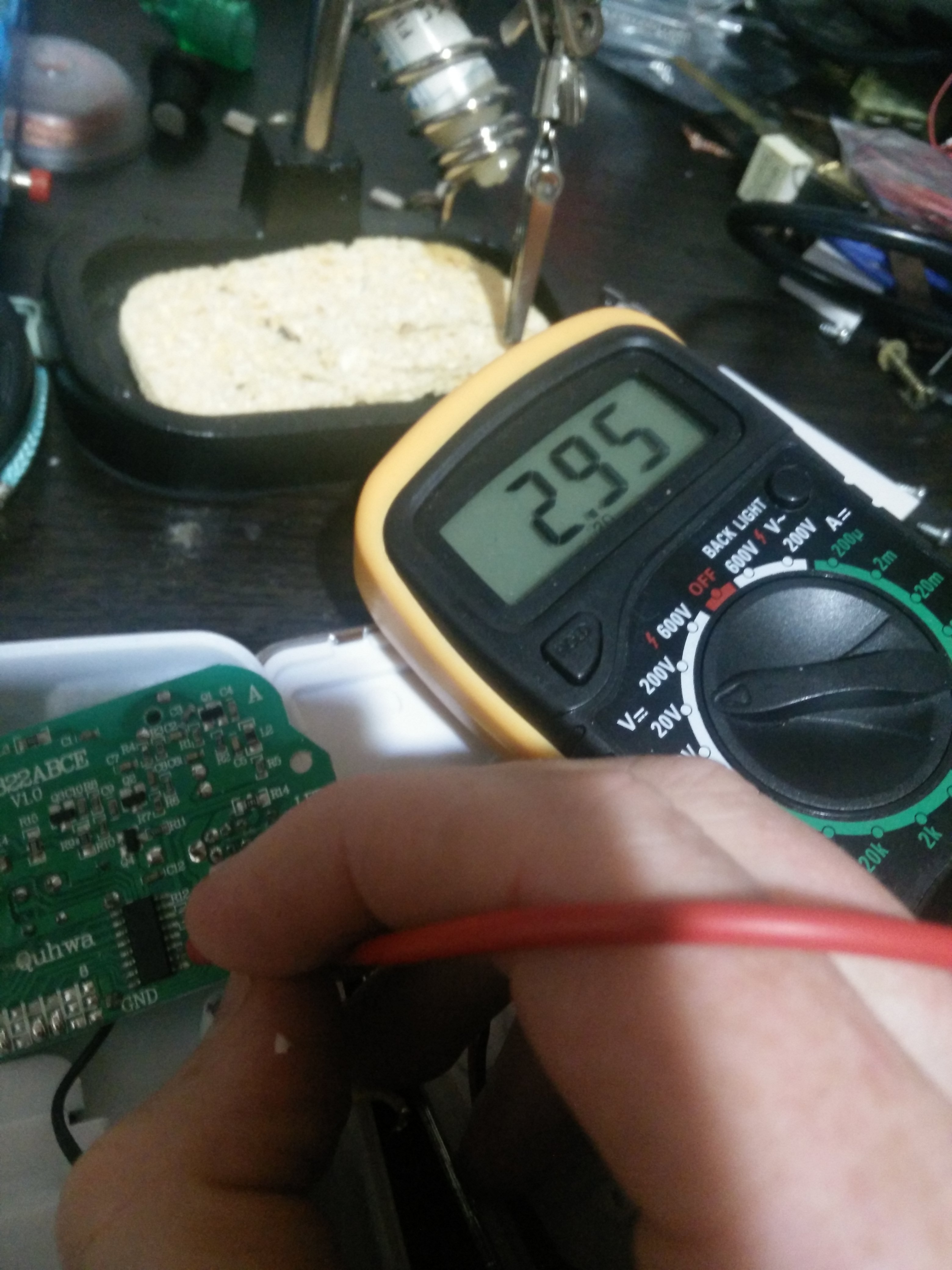

I recently picked up this cheap ($15) RF doorbell system and have been playing around with getting to work with a Promini and DFPlayer mini. the plan is to have a wireless Mp3 doorbell using the existing RF system.
After probing about i found that one pin on the IC inside the bell sits at 0v and climbs to 3v when the transmitter is pressed.
I've soldered a wire to the pin hoping that this 0v - 3v could be used as a low, high function on the arduino? if im completely wrong set me straight lol.
cheers.
Useless image is useless. Nothing to see there.
Is that an incoming or outgoing signal?
Anyway, what's stopping you from trying it out? Just make sure you put two or three diodes and small resistor (200-500 Ohm) in the line to drop the voltage to 3V (I assume you have a 5V Arduino) and limit current (protection of both sides - you don't know what you're connecting to really) and see what happens.

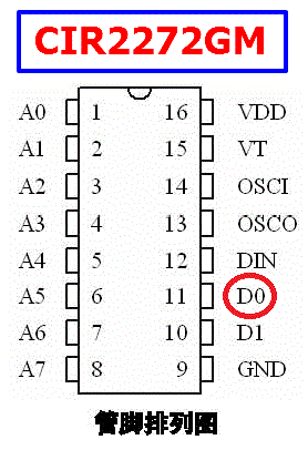

Here is a picture of the IC and the pin that sits at 0v untill the transmitter is pressed. im hoping this change can replace the function of a regular switch. this is the code i've uploaded to the arduino.
D0 of the IC is running into pin2 of the arduino

So you want to use this output to control the Arduino instead? First I figured it's the other way around.
Should work.
Connect the GND of Arduino to the GND of your door bell, 3V should be high enough even on a 5V system to detect as HIGH when you digitalRead() the pin. Otherwise you can always use an analogRead() and see if the value is high enough (should be about 600 for 3V).

Ok, i just uploaded this to the board
//Digital Read with Button
int pushButton =2; //digital pin 2 has a push button attached to it. Give it an name
//the setup routine runs once when you press reset
  Serial.begin(9600); //initialize serial comm. at 9600 bits per second
  pinMode(pushButton, INPUT); //make the push button's pin an input
//the loop routine runs over and over again forever
  int buttonState = digitalRead(pushButton); //read the input pin
  Serial.println(buttonState); //print out the state of the button
  delay(1); //delay in between reads for stability
and I'm getting 0's when not in use and 1's when the transmitter is pressed. so i guess it is working.
