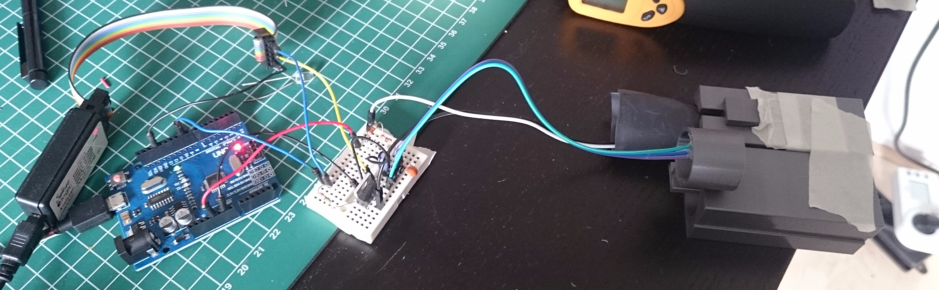

I'm trying to build a wireless light break sensor for equestrian sports-timing. Actually now I think of it, after this is done I probably want to build the timer as well.
I've had this project laying dormant for at least 4 years. But I have more time, space and a 3D printer for building the parts. And so a few weeks ago I start using parts I have around. An arduino, a mosfet an IR LED, a TSOP1738, and some custom made lens holders and two lenses an started testing.
I used code from Nick Gammon to create a 38 kHz carrier wave Modulated at 1 kHz. Connected the led, the tsop, connected a logic analyzer to the tsop and measured a minimum of 4ms low signal when interrupting the beam. I say Succes! I connected a LED to the output of the tsop and started testing outside. It seems that I have a reach of 40-50m.
After this long introduction I've searched and searched to achieve the following:
One module (arduino etc) to transmit a modulated IR signal, and this same module to receive the signal. If the signal from the TSOP is high for more then 3ms I want it to transmit a signal. Although at this point I have not decided what kind of wireless transmitter I'm gonna use but I won't be surprised if it involves SPI.
Transmitting the IR signal
I've already used the following code which I don't fully understand.
For example what does "|" do?

Receiving and interpreting the IR signal
The TSOP is active low. In the image that I added the signal is reversed.
I considered the following options:
  • Overflowing timer 0 every 3 ms, reset the timer when the signal from the TSOP goes LOW (interrupt).
  • Overflowing timer 0 every ms and increase a (volatile)variable. Reset this variable with every interrupt from the TSOP and let the timer go on
I would like your opinion about how to proceed.

According to the datasheet of this sensor the sequence has to be modulated. It isn't a beambreak sensor, but an IR data sensor. What is your range with the SFH400 in bright sunlight?
So the questions still stand, how to measure this "gap" of 3ms and what does | do
Data sensors like the TSOP1738 aren't designed for continuous carrier reception or beam break applications.
They expect periods of silence in order to do their automatic gain control and other housekeeping functions.
If it works for you, great, but don't be surprised if sometimes it's unreliable.

I have doubts about using more LED's vs. optics. My current LED is 20 degrees. While I'm certainly buying LED's with an even smaller angle I already have an high range.
Now the real questions are about the programming of the receiver part.
If the time between pulses is 3ms or more it means a beambreak. Normally it would give a pulse every 1ms.
Something like this?
if (!receiverOutput) { // if beam is detected
  trigger = millis(); // keep trigger updated with every loop
else if (millis() >= (trigger + interval)) { // if beam is interrupted longer than the interval time
  //do something
"trigger" and "interval" need to be declared as unsigned long.
The if statement might need extra flags for starting/stopping the race.
The else part could get the time from a RTC.

Anyway @Wawa, you reminded me that my timing was not that critical and therefore easy to measure.
I still want to try if I can combine the modulation and the receiving of the signal in one code and run it simultaneously. Next weekend perhaps.
So far there the transmitter has an average current of 80mA at 5V and the receiver 10mA at 5V. As long as I don't need any defogging a 1000mAh battery will be enough to power this for a day.
*I was outdoors around 9PM and with this dim light I had a range of 120m with ease. I even had to tighten the opening towards the sensor otherwise it was hard to block the beam. After I finish this project I will seriously consider lasertag.
