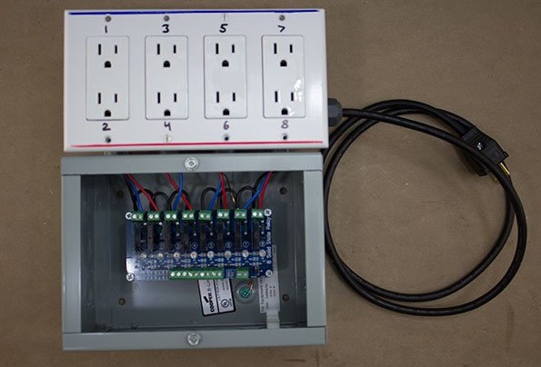

Attached image of the wiring sketch comprising arduino + bluetooth module + relay. Bluetooth connects to mobile app to toggle the relay.
I would like to know how to wire the on/off switch to the relays. Attached an image I found while googling but it doesn't give any information on wiring relays to the wall switch. The wires in yellow are what I need help wiring.

At the risk of sounding like a keyboard jockey smart-ass, I would recommend you hire a qualified electrician. Why? Because the photograph you posted (wire.jpg) shows that you are well outside your comfort zone of experience. That exposed, bare copper wire at the relay terminal blocks is lethal.
All of those parts and wire must be contained within an enclosure that is safe from inserted fingers and other foreign objects. You're risking bodily harm and fire working with household mains.
Quite frankly, if someone needs to explain to you how to wire a switch in series with a switch, you absolutely don't have the skill necessary to complete such a task safely.
The wiring photo is someone else's. I just googled it. Yes, I know that proper shielding/covering of components is essential to prevent any accidents.
When working with mains I'll definitely ask my local electrician to do the actual wiring.
Just would like to understand the process involved to increase my knowledge though.

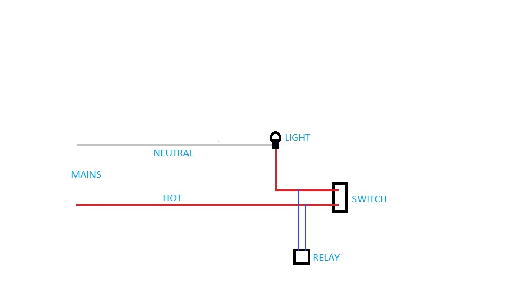

In my simple drawing, I show a 2 pole stardard switch, and a light bulb. What you want to do is put your relay in parallel with the existing switch, so either the relay or the switch will turn on the light.
Connecting the circuit may not be as straight forward as you want since the wiring will be inside the walls and not all run to a central point or "home run".
In the drawing, the grey wire from the mains is what is called (in the USA) the NEUTRAL wire. If you measure the voltage between a ground or earth point to this wire with no load on the circuit it will show zero or a very low voltage.
The red wire from the mains is called the "hot" wire. This is the dangerous one. If it connects through you to the neutral or ground you get a shock. This wire is switched because when the switch is open, the light socket and wire back to the switch is all dead. So this makes it safe to change light bulbs with the switch off. If the circuit is wired incorrectly then the bulb will be "hot" all the time but still will only light when the switch is closed.
Your relay contacts (the blue wires) will mimic the action of the wall switch to turn on the light.
The problem with doing this in an existing building is the way the building is actually wired. Normally the wires from the mains are run to the light fixture. From there an identical pair is run down to the switch. At the light fixture the hot wire from the mains will be only connected to one of the wires going to the switch and the neutral will go directly to the light socket terminal of the threaded part. The wire connected to the hot goes to one terminal of the switch. The other wire in the pair is connected to the other switch terminal and then to the center terminal of the light socket center terminal.
This example is only for a one switch, one light circuit. There are many variations.

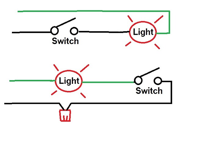

Light switching is pretty straight forward and works with opening one wire.
You can switch hots, or switch neutrals. Break one leg and the lights go out.
It is not uncommon to power the switch, and then run wire from the switch to the light.
it is not uncommon to run power to the light and then run the hot to the switch and then the second wire becomes a hot when the switch is closed, and therefore connect to the light. this is switching the hot leg and has the problem that the light has two neutral wires connected.
in a 3-way application the wiring becomes more elaborate and in the US, we prefer to use 3 separate colors, red, black and white. in the US. white is the neutral, so the red and black carry the hot side of the circuit.

Guys..how safe is this?
It is only as safe as the circuit protective devices which consist of fusing and circuit breakers in the correct places with the correct ratings. That project looks reasonable by US electrical codes for 120 volt mains. The solid state relay board contains inline pico fuses to protect the PC board, that is a good thing. I cannot tell if the relay board has the proper trace widths and spacing but since it has fuses, it's better than the Chinese boards without.
I cannot state suitability for 240 vac mains, your codes are quite different due to the different distribution methods.
The comment section had some typical Internet nonsense. The electrician comment that the box was wired incorrectly and it would cause inductive heating. That's pretty funny stuff. Yeah, that's why we switched to plastic boxes /sarc.
