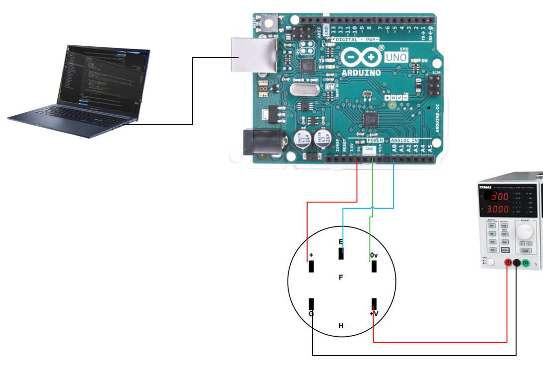

I am trying to wire up a turbine flow sensor (datasheet) to an Arduino Uno and collect the data but I am not sure how to do the wiring for it. I have attempted to wire it up (see wiring diagram) but I am not getting any results. From the datasheet, I am assuming the sensor needs two separate power sources (one is for the LED).
I have tried: getting both from the Arduino Uno (5V and 3.3 V) as well as getting the 5 V from the Arduino and 3 V from a power supply, the latter is what's shown in the wiring diagram.
Is the wiring diagram correct?

Datasheet circuit diagram:
Wiring diagram:
If you connected the power supply to the LED without any current limit (resistor) you may have already burned the LED. Did you limit the LED current?

Based on the wiring diagram, I thought the resistor was already included.
I did originally use the 3.3 V from the Arduino to power the LED, could this have damaged the LED (it's max is 3 V)?

All I meant was that, whatever configuration you use, Uno is capable of powering a LED. That includes using the 3.3v pin. I fail to see why there should be a 3.0v maximum, and I don't believe it either. That said, a voltage divider on the 3.3v pin means just an additional resistor. I imagine 'Fungus is right and, assuming you are using water, you need a minimum brightness from the LED, and a 600r/1.2k divider may suffice, thereby giving you 2.2v. There is better information on LEDs in the Arduino reference.

The very first page of the document you linked to states that an external current limiting resistor is REQUIRED.
Maybe the optical circuit relies on there being a substance with the refractive index of water present for correct operation.
You need to see if LED has been damaged. Check continuity of the LED citcuit using the diode range of your DMM. Connect the DMM red lead to LED (V+) and black to ground or common. You should read continuity (anout 3V). Reverse the leads and it should read open. If it reads open both ways, the LED is probably burned.
