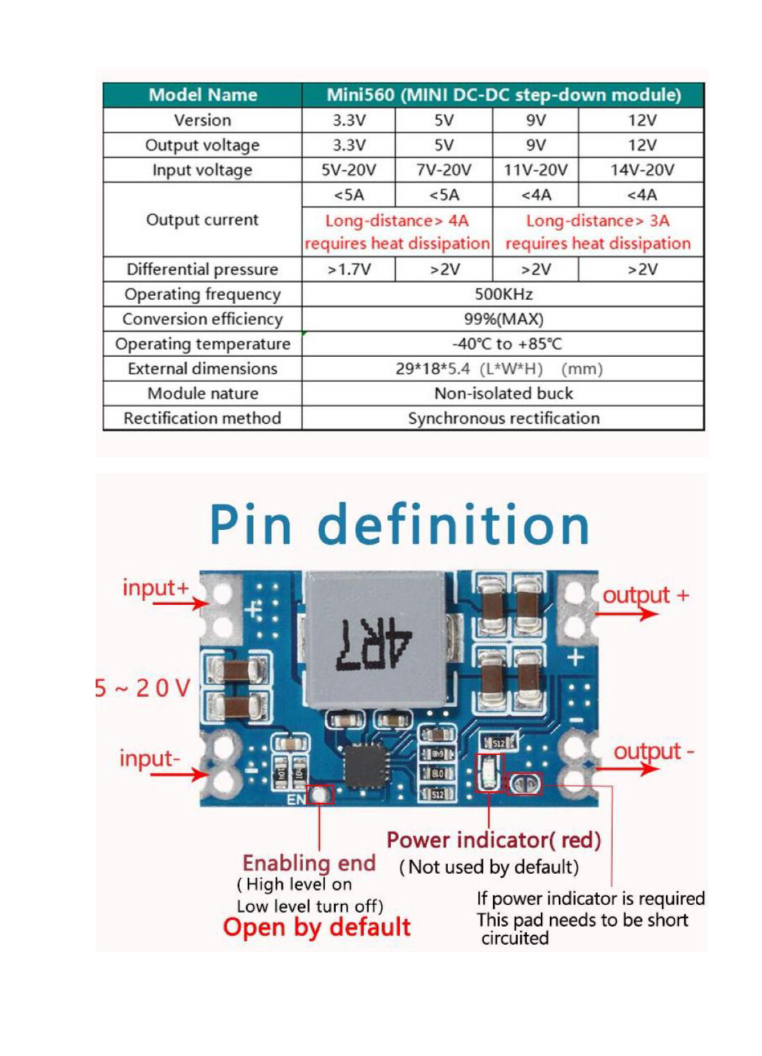

I did some more research and discovered the MINI560 3.3V DC-DC step-down regulator. It should be more efficient than the AMS1117, but I also found that it produces some noise on its output.
“As a switching regulator, it produces some ripple and switching noise.” - chat gpt
Is this true, and how can I filter this noise? Also is added complexity worth the efficiency gain compared to ASM1117?
Opinions will differ on this. I usually just use a linear regulator. But it would depend on how much difference it makes. If the voltage drop across the regulator isn't very great, then a linear regulator may work well enough. But if it's a large differential, then you'd be wasting a lot of battery power generating heat. Another consideration is that switching regulators may lose their advantage when load current is low, so if your circuit sleeps a lot, a linear regulator could actually be more efficient.
If it were easy to filter out the noise, they would have done it on that module. But see the EEVblog video on capacitance multiplier.
Anyway, you'll have to do some number crunching. How much current will the regulator have to supply on average? What is the voltage drop across it, and how do those losses compare to the roughly 85% efficiency of a buck converter?
