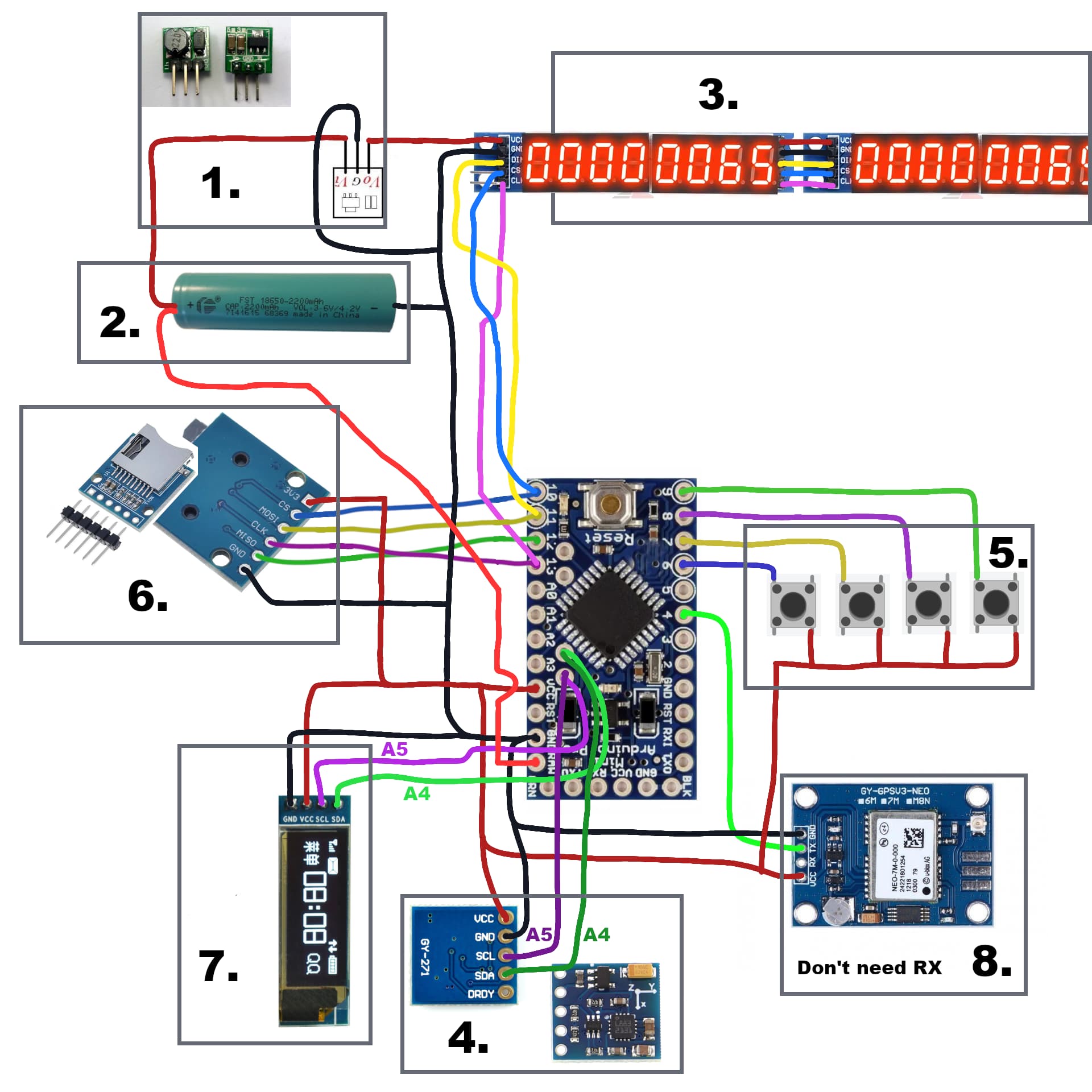

I'm working on a portable project using an Arduino pro mini (Atmega328 3.3V 8MHz) that needs to: receive GPS and magnetometer data, process and display this data on 7 segment and OLED displays, save logs to a microSD card, and have few buttons to press.
Since it's portable, I'm powering it with a single 18650 battery that is connected to RAW pin. I'm using a small DC-DC converter to 5V for MAX7219 and 7 segment displays. All other components are running from VCC pin.
Below is my circuit diagram (sorry if it's messy, I hope you can read it), along with pictures of exact modules I plan to use. I'd love your feedback on whether I've wired everything correctly or if there's some better approach. I'll also provide the Arduino pro mini pinout diagram I followed.

Hi, @ruku
Have you built your project yet?
The LED display will probably be the biggest load on your battery.
Don't forget that with DC-DC converter, power input will be a little higher than power out, and that the input current at 3V7 will be higher than the 5V current going out of the coverter.
If you look up the specs of all your components you may be able to make an energy audit.
So you can see where your energy is going and how long the battery will stay within the acceptable battery output range and the circuits power input range.

I would be concerned that the little 3.3V regulator on the Pro Mini would be able to source enough current to supply the parts running on it, particularly the SD card.
I wonder if the things that need 5V could actually run on the battery directly, down to maybe 3.5V. Then instead of the boost converter, you could have an external 3.3V regulator to drive the Pro Mini and other 3.3V parts.

The regulator on the original Sparkfun 3.3V Pro Mini is the MIC5205, which is a 150mA regulator. I doubt the typical clone from the Far East is any better than that. SD cards can draw significant current when erasing and writing, but the current draw can vary a lot from one brand to another. So you really need to determine what each of your devices needs in the way of voltage and current, and figure out how to power them. The advantage of the external 3.3V regulator is that you should be able to find one that provides a lot more current, but still with a very low dropout voltage, and you can fan out its output to everything that will run on 3.3V, including the Pro Mini itself (at its Vcc pin).
I know the MAX7219 datasheet says it needs 4V, but I suspect it will run ok powered directly from an 18650. Then you could not need the boost converter unless there's something else that needs a higher-voltage supply.

If it's the former, I can see a dangerous fault in your circuit.
Does the Pro Mini have enough memory for all this ?
Ah, those seem to be connected incorrectly. They should be connected between the Arduino pins and ground, not Vcc.

There is some good advice on that link: "To prevent fire or personal injury". But you are not following that advice. Like I said, a dangerous fault in your circuit.
I'm disappointed that you have not yet asked what it is that makes your circuit dangerous. Maybe you have given up on the project. But in case that's not true, I must tell you, for your safety.
It does not appear that your 18650 battery has built-in over-discharge protection. Most 18650 do not have that. A few do have protection, and these have a small circular PCB at the negative terminal and a metal strip running along the length of the battery which lets that PCB monitor the voltage if the battery and disconnect it from the circuit if that voltage falls below the 2.75V limits recommended in the link you shared.
Your DC-DC converter will not provide such protection.
If allowed to over-discharge, the battery can become permanently damaged. When re-charged, it can heat up, burst into flames or explode. This is no joke. You will have heard stories about lithium batteries causing problems like this, I'm sure.
So you will need a over-discharge protection module in your circuit.
