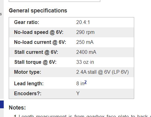

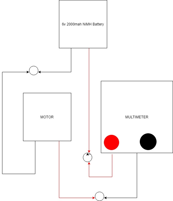

I ran a series test to test the current through the DC motor (6V NiMH Battery to probes of multimeter in series). The datasheet says stalled @ 6v should give me about 2.4A. I'm only getting about 2.08. Would this be because of heat loss and whatnot?
What is the voltage you measure across the motor terminals when stalled? It's probably less than when freely running. Internal resistance of the battery, wire resistance, contact resistance, switch resistance etc. all come in play.

when running, I'm getting .07 A
When stalled, I'm getting ~2.08 A
How can I test no load current and no load speed?
Ammeter resp. RPM meter.
