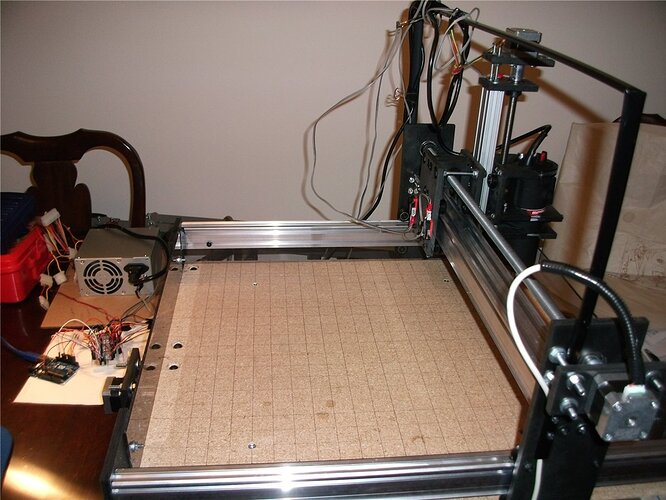

first of all-i like to thank you all for your responses.i did wire the switches as in diagram that i've posted above with 10K resistors. didn't work at all. i would assume it was due interference? i've ended up with 330 ohm resistors. this bring me to a next question-everyone is talking about best wiring practices, but i have no idea what exactly do they mean and how to apply it to my particular case. here is a close up on my setup on pic below. obviously a far cry from best wiring practices. i wired the limit switches with some speakers wire. whole thing looks just plain ugly after i done with it. can anyone give me some advise about what should i do to reduce the interference and where can i read about wiring management on such things like home made CNC?

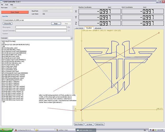

another question i have is about homing. i've made a short vid of how things are working after i've added limit switches and press $H command in GRBL(without running $H first-machine would not respond to anything, giving me alert lock)
is this is how it's suppose to be? i did enabled hard and soft limit with soft limits are set to x=300,y=200 and z=100 mm. what happens after i send $H command is that machine would go first into a top of z -smashes into limit switch few times, then stops at very top, maybe 1-2 mm away from top switch on z. then it goes to far corner,does same on y,but hit switch only once on x and stayed there, in the corner,defined in soft limits. which doesn't looks logical at all.

As to wiring, get some cable ties:-
Cable ties
Next get some pin headers and solder the whole row rather than individual pins, it is much more robust.
Pin Headers
You might want to consider some multicore cable
Multicored cable

here is where i stuck(while trying to make an sort of engraving of a logo my son's favored game- wolfenstein): with homing(and soft and hard limits off) if i position the spindle manually in lower left corner (machine itself positioned as it was on grbl controller application)-ie- if i use grbl's controllers arrows to move spindle in any direction-left,right back and forth and up or down-it does it in same direction of the arrow buttons on grbl controller. now- once again-if i position the spindle in lower left corner manually, using grbl controller arrow buttons and then load .nc file pictures above with g code and press begin-everything works fine.

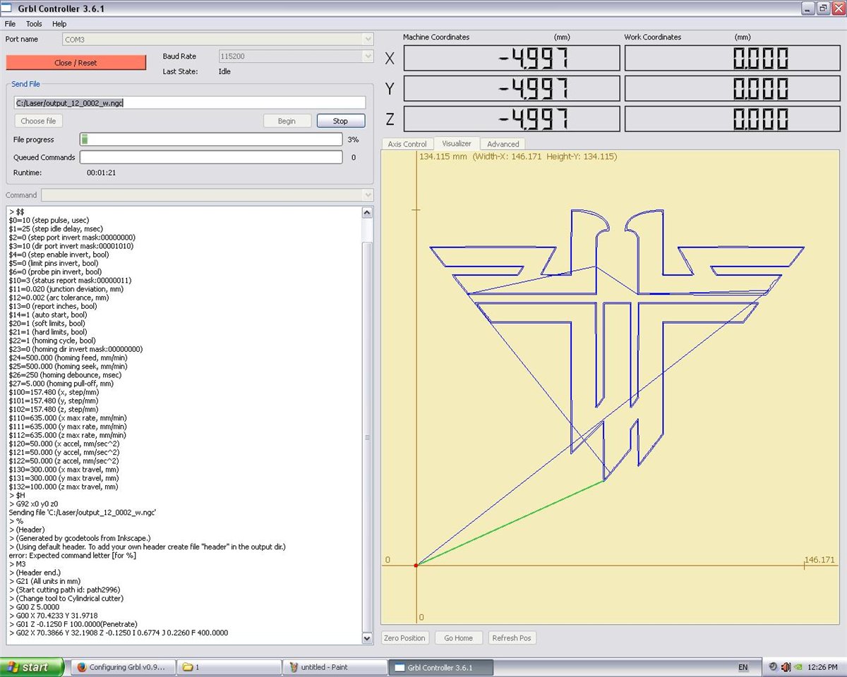

but! when i enable homing,hard and soft limits and load same file after i've performed homing and press begin-nothing happens(pic 3).
pic 1-machine after start and homing done

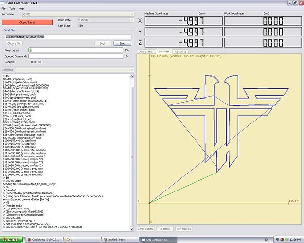

in pic 2 i'm trying to explain where position actually is after $H
and pic 3-what happens after i done homing and tried to run the code.
i press begin and that was it. nothing happens. not a single move. not sure why. i also don't understand how to get the machine in "sync" if you will with grbl controller application, which assumes than when machine is zeroed-it should be in lower left corner of working area, before it's starts working.

With homing enabled on GRBL nothing will happen until you home the machine, then zero your machine and start the file. The newest version of GRBL actually says that on startup. I have a lot of trouble with GrblController, have switched to Universal G-Code Sender, and it seems to handle homing better.
Also try reading this Quick GRBL setup guide for Windows (Arduino G-Code Interpreter) | Protoneer.co.nz
Tells how to modify homing directions ect.
