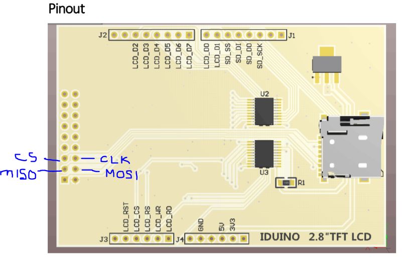

If you want to access the SD card from a Mega with a tft Mcufriend shield some shields have these holes off to one side User Manual For 2.8" TFT Touch Shield for Arduino with Resistive Touch Screen (TF028) - PDF Free Download. After playing around I found that you can connect to the SD card by connecting pins 50-53 to the holes labeled in the JPG attached
Yes, you can connect pins 11-13 on the Shield to pins 50-52 on a MEGA2560.
It is RISKY. This only works if 11-13 are INPUT mode. Otherwise the Port output pins are fighting.
Much safer to use Software SPI as in example.
David.
PIN 53 is the CS Pin on a Mega
Yes, you can connect digital #10 to digital #53 too.
This will ensure another output BATTLE
