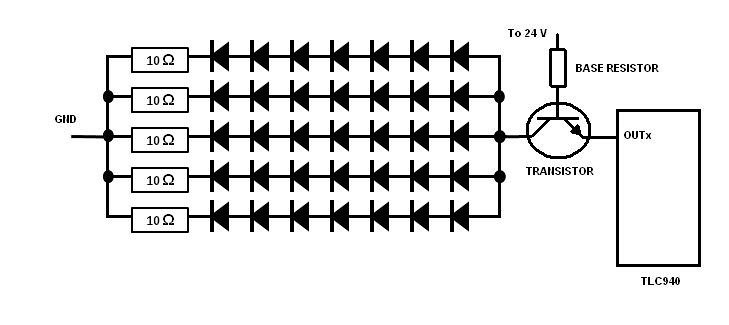

last question though, i already bought some N-channel mosfets ( FQP1306 http://sm0vpo.com/_pdf/FQ/FQP13N06.pdf ) and i've been reading the http://focus.tij.co.jp/jp/lit/an/slva280/slva280.pdf. and as i understood it works the same way as the transistor you mentioned, and will be wired the same way. I can though see the idea in your suggestion, the price is much more cheaper.
i drawed a wiring based on your explanation, is that correct ?

Yes but with that circuit V+ can only be +5V, any higher and you can't turn the transistor off, and +5V is not enough to run more than one LED. So no series wiring, it will have to be parallel with a resistor for each LED.
@stregoi
No that circuit is all wrong, the TLC will only sink current so there is no way for the LEDs to get any current.

now i am kind of confused .. i've been told in a earlier post that i cannot use led's in a parallel wiring with the TLC5940. and that no need to use a resitor for every led.
how should i understand this ?
By actually reading what has been said:-
Yes that is why we are talking about not wiring the TLC5940 to the LEDs but to a transistor, the transistor is driven from the TLC5940.
Yes ONLY IF they are in series, if they are in parallel then you need to.
Again that circuit will not work because you can't get 24V out of a TLC5940 and therefore you will never be able to turn that transistor off.
In which case when it is off you are presenting the TLC5940 with 24V, this chip has a maximum voltage rating of 17V and so you will blow it up and it will not work. There is an application note to tell you how to use higher voltages it's number is SLVA280.
