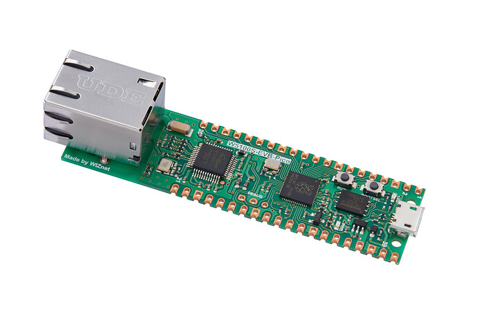

Hello, I was wondering has anyone used the wiznet 5100s? I have used the normal 5100 but I’m seeing. 5100s. I’m not sure what the difference is. I’m trying to read the data sheet now but unsure. I was just curious if anyone has used the ‘S’ version?
Joseph
The current Ethernet_Generic library doesn't support that WIZnet W5100S.
I've modified and will release new version of Ethernet_Generic library to provide preliminary support to
  1. WIZnet Ethernet HAT
  2. W5100S-EVB-Pico
for generic boards or RP2040 using arduino-pico and ArduinoCore-mbed cores.
Check the progress in Wiznet W5100S #56

Hey khoih-prog, How you doing? Been a while. Thank you. A friend of mine gave me a few of these modules. And currently I only have a arduino zero board to test theses on.
Joseph
The Ethernet_Generic releases v2.1.0 has been published to provide support to W5100S shield /module, such as WIZnet Ethernet HAT and W5100S-EVB-Pico
Releases v2.1.0
  1. Add support to WIZNet W5100S. Check Wiznet W5100S #56
