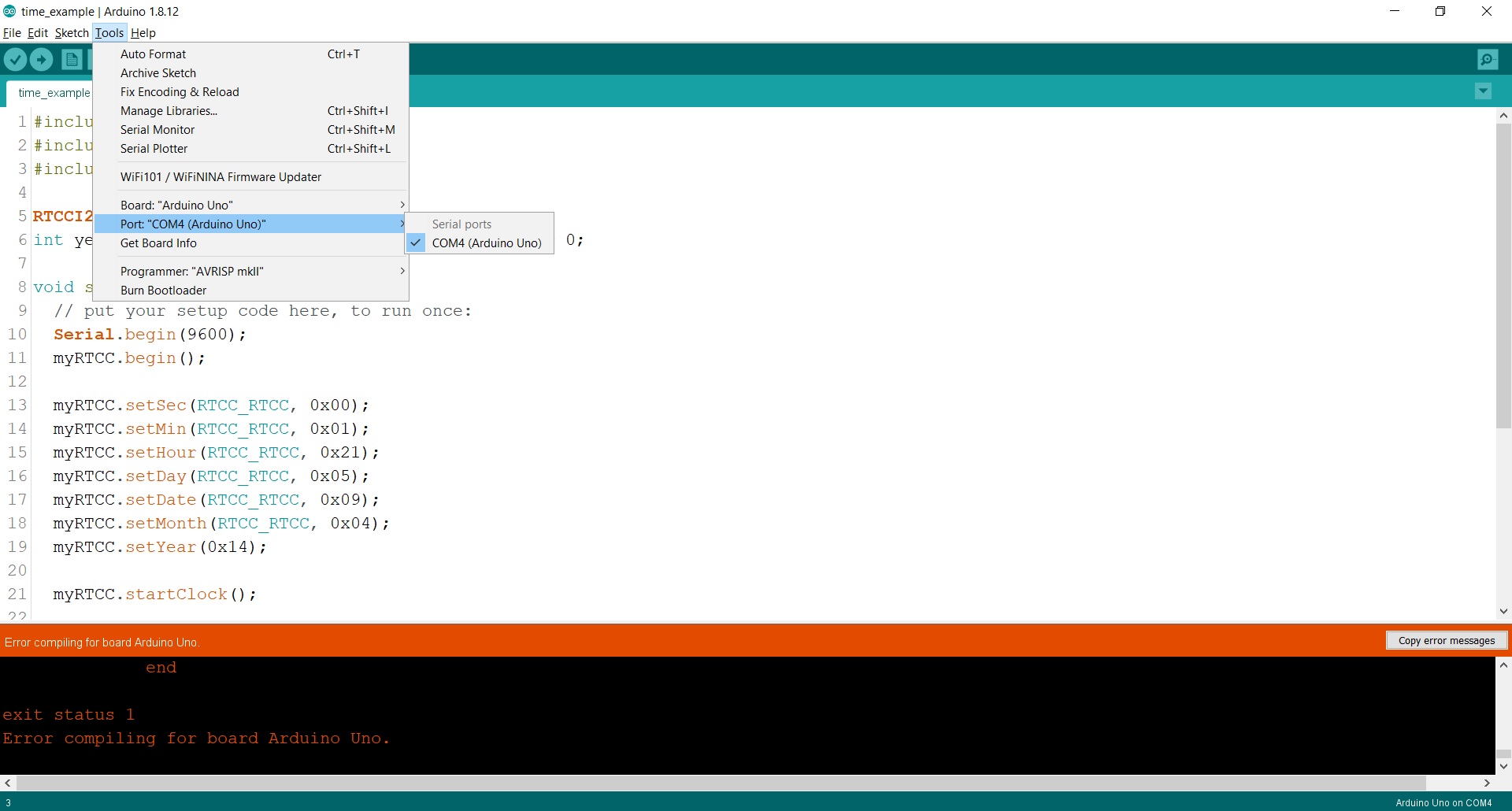

Hello,
I'm trying to write a test sketch to practice working with the PmodRTCC module found here. I am able to get the program to compile (but not upload) when I select one of the Digilent boards within the Arduino IDE, however I get a rather long collection of errors when I try compiling it with my Arduino Uno as the selected board.
I am using the RTCCI2C library found on their webiste (automatic download).
Does anyone have any insight on what the issue might be?
The error is quite lengthy so I'll post it below.
For reference, this is my code that I am working with:

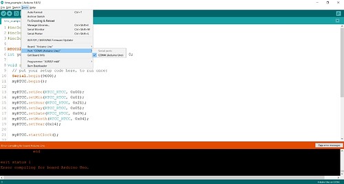

Use "Tools" in the IDE monitor and check "Port".
I'm only able to select COM4 (Arduino Uno)
Good. That's not the issue. My mistake.
What about including "wire.h" before RTCCI2C.h? A wild guess.
The error report tells something wrong with wire.h. One more guess, if the above doesn't work, is to omit the include of wire.h. Maybe the RTSSI2C fixes that by itself.
Hmm... that didn't solve it either. I'm still getting the same error.
It's saying that it's not liking how Wire.[whatever] is working? This is leading me to think that it may be an issue with how the library is coded maybe?
I was reding the error report as certain members of wire.h is abcent. Maybe another library contains a Wire of some kind but withound the functions being needed. This is way beyond my knowledge. Let the night pass and wait for more knowing helpers to step in.
