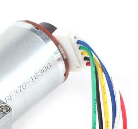

If this is what you have, I'm most sure you can follow the black and white image I showed earlier.
Black to GND
Blue to 5V or VIN
Yellow to one digital pin
Green to another digital pin
So the red and white go to your motor driver. You set the speed and direction of the motor by sending the right signals to your motor driver. That depends completely on what kind of driver you have. Usually you send digital LOW to one pin and a PWM to another pin. The PWM determins the speed. Switch the LOW and PWM pins to make the motor go in the other direction. All this has nothing to do with the four other wires. Those you need to keep count of how much the motor has rotated. You create the logic for that in your program. Although I bet there are libraries for that.

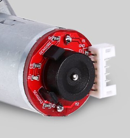

Looking at this:
...it seems there are two Hall sensors next to the motor axis. I bet you get one pulse per revolution of the motor axis. Somewhere was mentioned 20 pulses per revolution. That would be the shaft, after a 1:20 ratio of the worm gear. So 3 revolutions means 60 pulses, and one revolution on the big plate. 60 pulses, 360 degrees on the big plate. 1 pulse is 6 degrees. Your 26 evenly distributed openings would be 360/26 or 13.85 degrees per opening. With 30 openings you would get 12 degrees or 2 pulses per opening. Just saying.

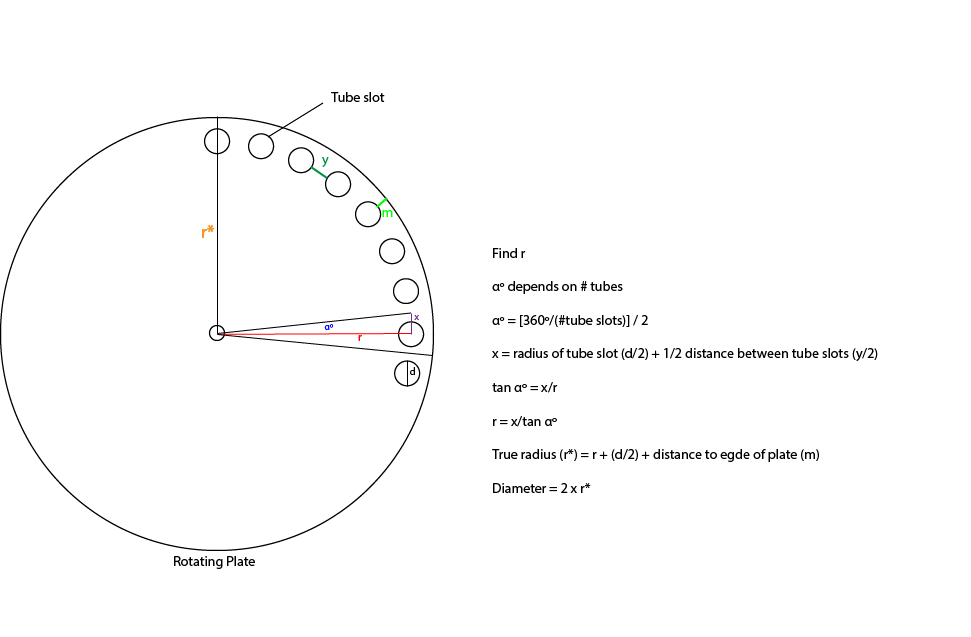

we can determine exact angle and location of each opening via the math and diagram below -please his comment on BEST EASIEST direct drive motor that is precise and stops “on a mm”

Your diagram might be correct, but it looks over complicated. I'd just go by designing it by heart. A 12" plate. 26 slots. That's 13.85 degrees per slot. I'd draw a few radii on the plate, 13.85 degrees from each other, then I'd place the tube holes on them, considering how far from the edge they should be and how near each other they can be. I might want m equal to y. I bet d is some predetermined value.

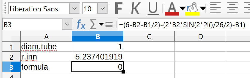

Or I could have some fun with LibreOffice Calc. With the Goal Seek I did this:
I decided the tube diameter would be 1" (B1).
In B2 I have the value of r, the radius of the inner circle, along which the tubes are placed, according to your drawing.
In B3 I have a formula, which calculates the difference between m and y.
With the Goal Seek I search for a value for B2, where B3 becomes zero.
As a school assignment, I would have to solve that analytically. But that was 40 years ago and life is too short. And LibreOffice is great.

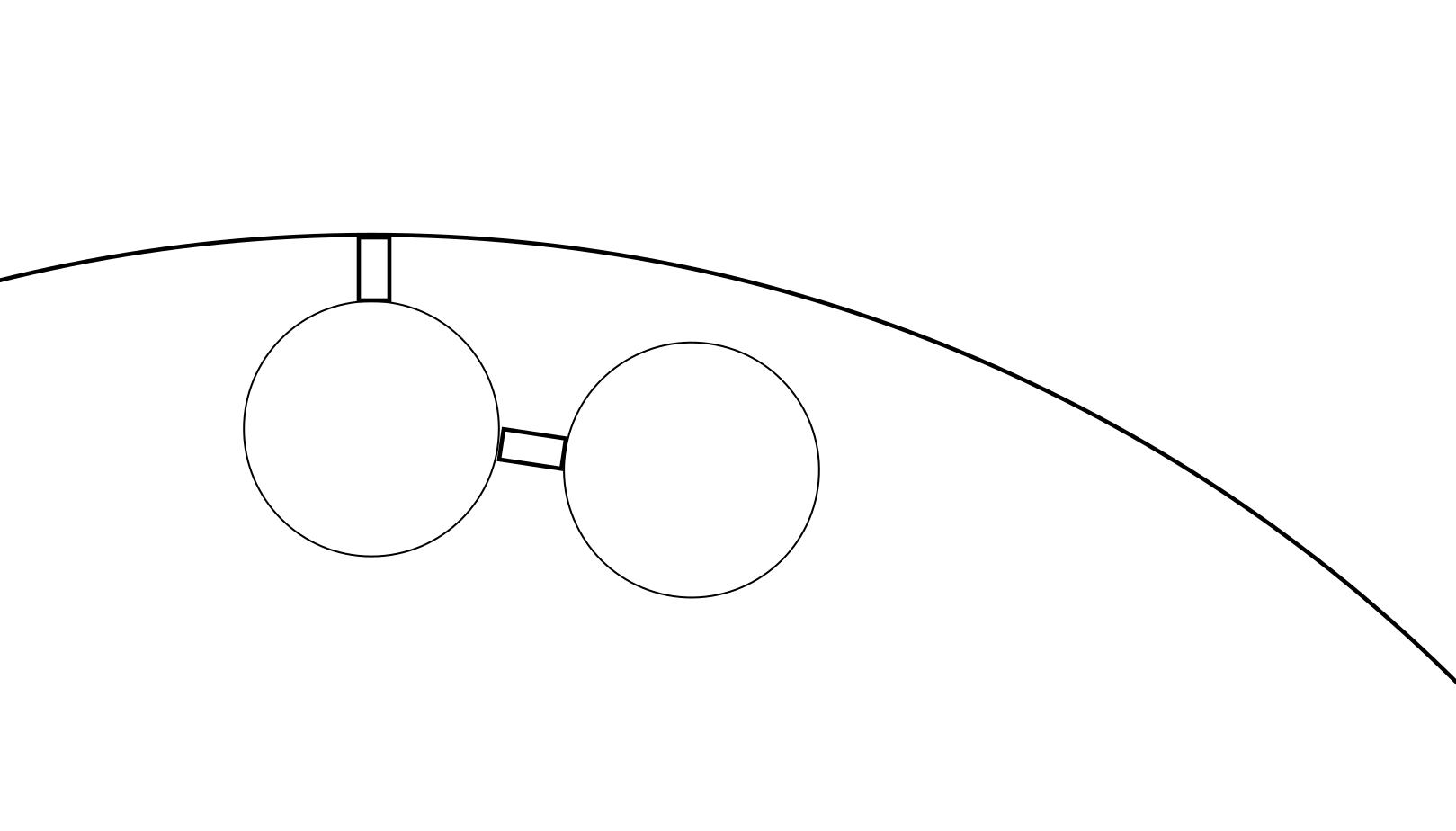

Here's how that looked like in Inkscape, when I placed two 1" circles on a 12" circle, at the 5.23" radius and 13.85 degrees apart:
The small rectangles were there just to verify that m equals y.
