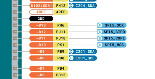

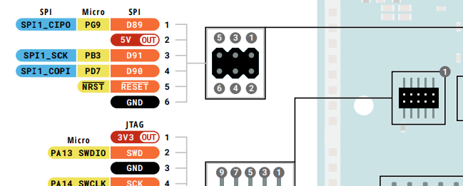

For example, are you using the SPI object pins (Which confusingly are shown as SPI1 in the schematic. This is the underlying hardware Wire object used for the Software SPI object
or the SPI1 pins? Which are hardware SPI5 object as shown on their pinout.

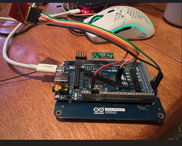

On my GIGA, I currently am using the SPI pins with the real simple Sparkfun adapter
And I have SDFat configured like:

in Setup I have:
if (SD.begin(SD_CONFIG)) {
Note: I am using the DEDICATED_SPI as there is no other SPI objects being used. If you have other SPI objects on the bus, then need to use SHARED_SPI.
IF you are instead using the pins on Shield connectors, then you would specify the SD config to be something like:
#define SD_CONFIG SdSpiConfig(CS_SD, SHARED_SPI, SPI_CLOCK, &SPI1)
