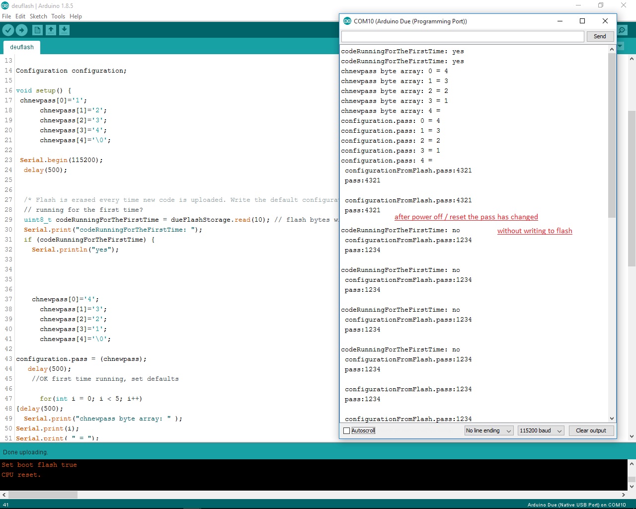

new update
after changing my code to the below --
the password is changing to 1234 instead of 4321 after power off /reset
it means password is not stored in flash memory
#include <DueFlashStorage.h>
DueFlashStorage dueFlashStorage;
String newpass , flashpass;
 char chnewpass[5];
struct Configuration {
  char* pass;
Configuration configuration;
 chnewpass[0]='1';
      chnewpass[1]='2';
      chnewpass[2]='3';
      chnewpass[3]='4';
      chnewpass[4]='\0';
  /* Flash is erased every time new code is uploaded. Write the default configuration to flash if first time */
  // running for the first time?
  uint8_t codeRunningForTheFirstTime = dueFlashStorage.read(10); // flash bytes will be 255 at first run
  Serial.print("codeRunningForTheFirstTime: ");
  if (codeRunningForTheFirstTime) {
    Serial.println("yes");
    chnewpass[0]='4';
      chnewpass[1]='3';
      chnewpass[2]='2';
      chnewpass[3]='1';
      chnewpass[4]='\0';
configuration.pass = (chnewpass);
    //OK first time running, set defaults
      for(int i = 0; i < 5; i++)
{delay(500);
  Serial.print("chnewpass byte array: " );
Serial.print(i);
Serial.print( " = ");
  Serial.println (chnewpass[i]);}
{delay(500);
  Serial.print("configuration.pass: " );
Serial.print(i);
  Serial.println (configuration.pass[i]);}
    // write configuration struct to flash at adress 4
    byte b2[sizeof(Configuration)]; // create byte array to store the struct
    memcpy(b2, &configuration, sizeof(Configuration)); // copy the struct to the byte array
    dueFlashStorage.write(4, b2, sizeof(Configuration)); // write byte array to flash
    // write 0 to address 0 to indicate that it is not the first time running anymore
   dueFlashStorage.write(10, 0);
  else {
    Serial.println("no");
 byte* b = dueFlashStorage.readAddress(4); // byte array which is read from flash at adress 4
  Configuration configurationFromFlash; // create a temporary struct
  memcpy(&configurationFromFlash, b, sizeof(Configuration)); // copy byte array to temporary struct
Serial.print(" configurationFromFlash.pass:");
Serial.println(configurationFromFlash.pass);
Serial.print(" pass:");
  flashpass = configurationFromFlash.pass;
Serial.println(flashpass);
//Serial.println(flashpass);
  Serial.println();
  delay(10000);}
